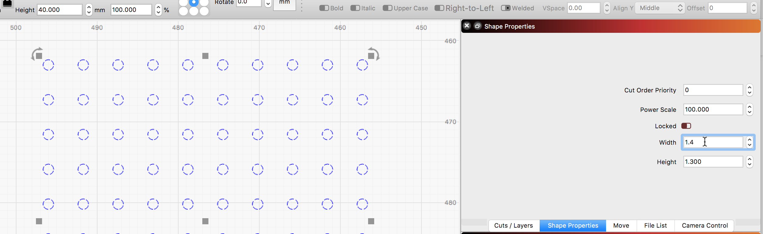

Hi,
I have a drawing with multiple holes.Those holes are 1.3mm now. It turnes out this is to small. They need to be 1.4mm. Is there a way I can select them al and change them all at once?. They are also grouped in groups of 3. They need to stay in their positions (center).
I am doing it by hand now but if there is a better/easier way… :slight_smile:
thanks and greetings.
@SIlverApe Aaron. I just tried this and I think it does what you want.
Resize one of the circles to 1.4. Select all the circles, selecting the 1.4mm circle last. Holding down the shift key, select “make selected items the same width” or “make selected items the same width”. Since it’s a circle, they both do the same thing. All the circles will be 1.4mm.
The issue will be gang changes to your groups. When a group is selected, you are changing the size of the group, not the objects contained within. Those would need to be Ungrouped first, then the flow @gwilki suggests would work.
Additionally, to keep things “…in their positions (center).”, remember to use ‘Center’ in your 9-dot control toward the right side of the ‘Numeric Edits’ toolbar.image

If the shapes were all LightBurn ‘Primitive Shapes’ (native circles, squares, polygons, etc), and are all the same type the shape properties will let you change properties such as ‘Width’ and ‘Height’.

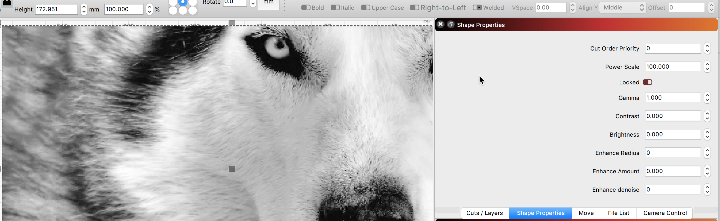

You are looking at the same window as I am. My view shows additional information because of what I have selected. I have ‘Primitive Shapes’ selected, in this case, some ellipses. Here is a view when I select an Image.

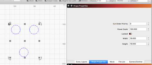

Did you convert the circle to a Path? That would change the behavior and not allow what I am suggesting. If so, don’t do that.
  • Draw an Ellipse
  • Select Ellipse and Copy using CTRL-C
  • Paste copied Ellipse two times using CTRL-V
  • Select all 3 Ellipse with Shape Properties window displayed.
My result in the image below. All shapes will need to be in their primitive state for this to work, allowing all of the same primitives to be adjusted at the same time.
The multi-editing of common shape properties for rectangles, ellipses, and polygons is new for the 0.9.17 release. It was supposed to work that way from the beginning, but didn’t.
