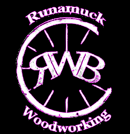

I am using Lightburn on a Scienci Longmill. A friend just asked me to do his logo for cutting boards etc. It is currently roughly business card shaped. The background color is black with the logo in light grey. I would like to change the black background to white or eliminate it all together. Is there a way to separate the logo from the background ?

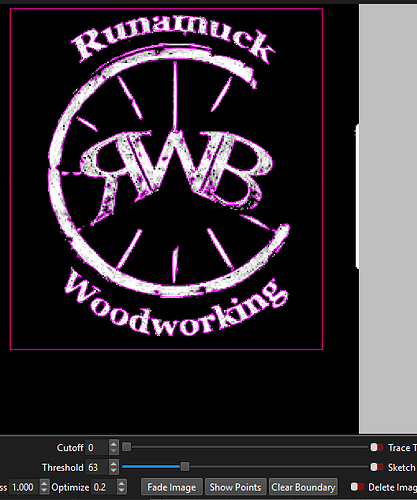

Right click on the image. Click on TRACE. Adjust slider bars in the window to highlight what you want.
Click on OK to create a SVG object copy of the image. Do that and show us a picture of your preview screenshot and your cuts and layers window. Then we can finish the transformation.

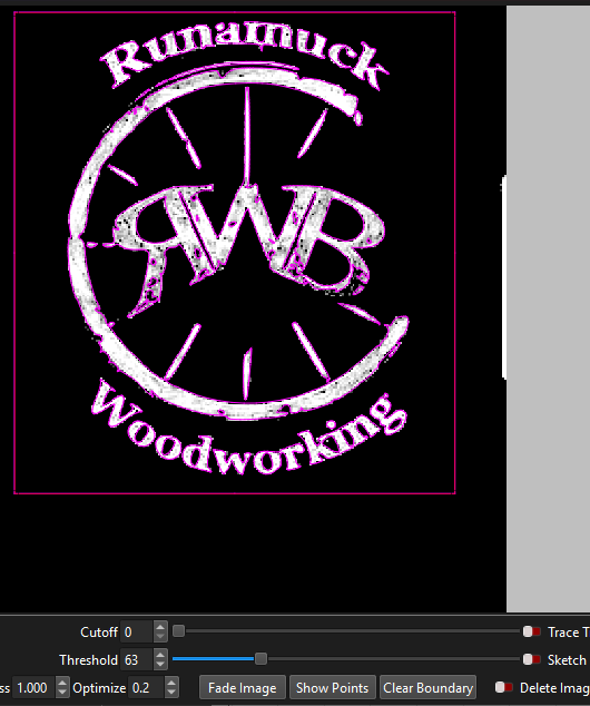

OK Jim, I’m not sure what In did, but trace now shows up. I moved the slider bars and got it to a grey back ground with grey lettering. Here is what i was sent as a jpg.
Image Trace is an available option for a selected jpeg file. Please explain what you see, helping us better understans your use of “stuck”.

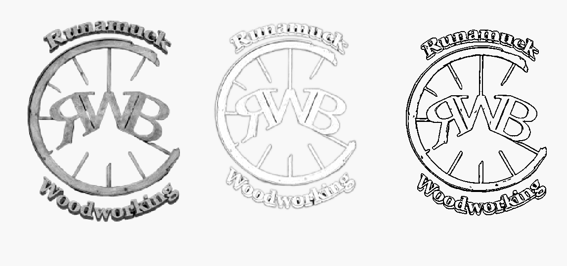

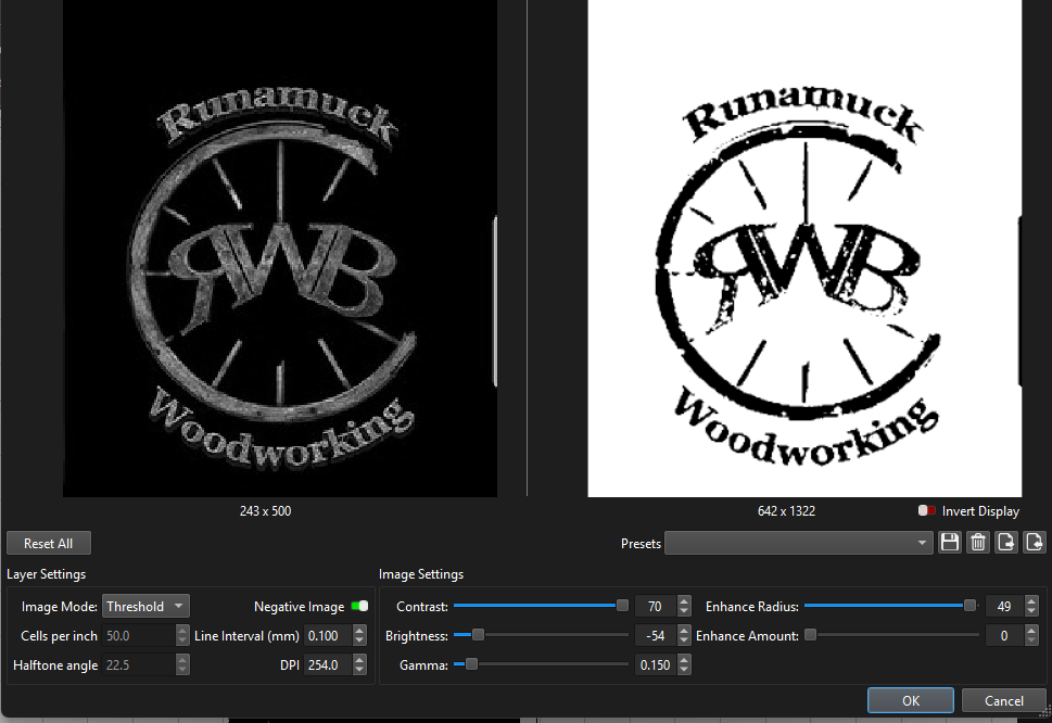

The JPEG is not ideal, but you can work with it. The “noisy” colors can be a challenge, but you have tools under the ADJUST IMAGE button and the TRACE button that will help you extract a good SVG.
Here is a quick image adjust that brings out most of the detail.
You can trace this setting
and get this object
This example is from a GREYSCALE image (it will emphasis different parts of the imgae)
You can break the SVG into parts, and reassemble the pieces that work best for you. In the long run, you may decide to focust on the central design and manually add the outer text - that is another skill set :wink:
