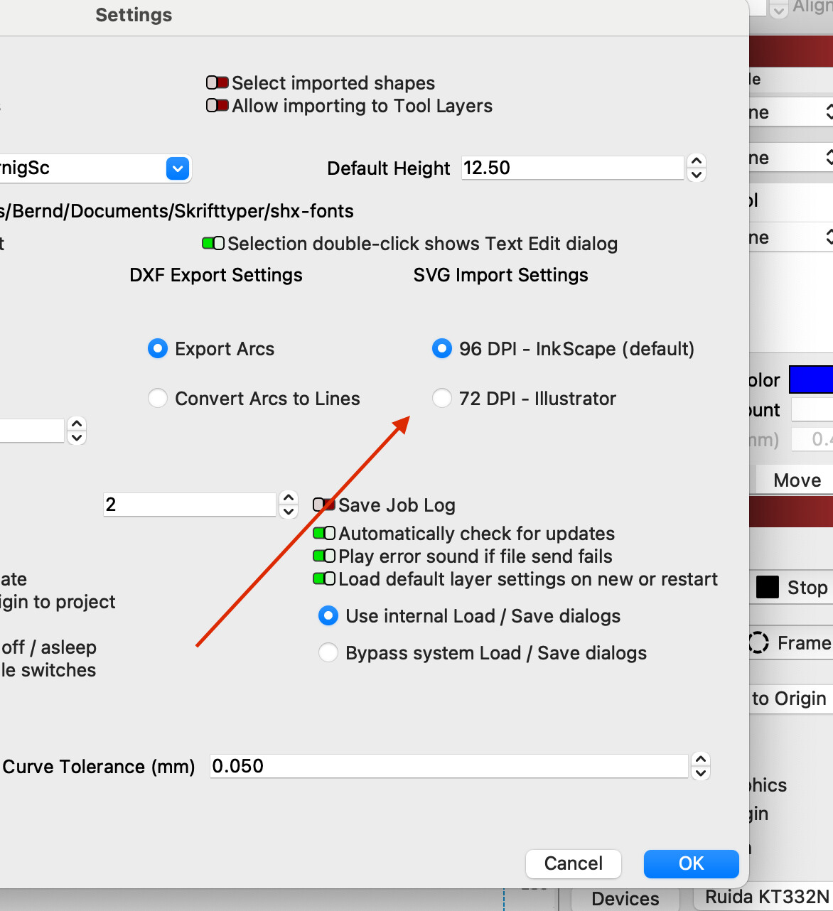

Changing dip on a file in lightburn
Is this possible in Lightburn? Thanks
Our SVG files are created in Illustrator, which exports files at 72 dpi. When opening SVGs, some programs will scale down the size of the SVG resulting in an incorrect size. Most programs should have the option to import the SVG as 96 dpi or 72 dpi, please choose 72 dpi to solve this issue.
