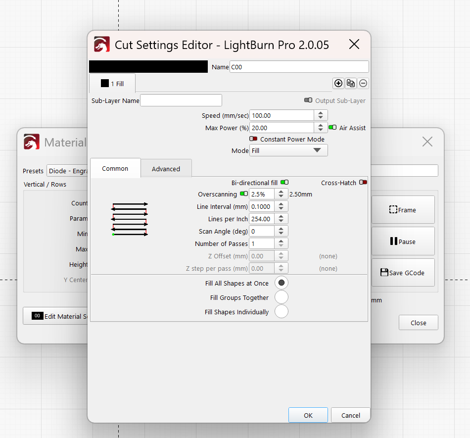

Hello, I have a little problem with the material test. I have a custom made lastercutter that engraves by moving the Y axis (north to south). I would like to use the material test to get to the right engraving parameters, but I cannot find a way to engrave the test on the right axis. With my regular engraving I have set the scan angle on the layer to 90 degrees, but I seem not be able to do that in the material test. Does anyone know any way to fix this without changing the whole coordinate system of my lasercutter?
Thanks in advance!
Hi @Wouter
The best I can offer is that you can Edit Material Setting and change Scan Angle there.
click the Edit Material Setting button and the dialogue will pop-up.
