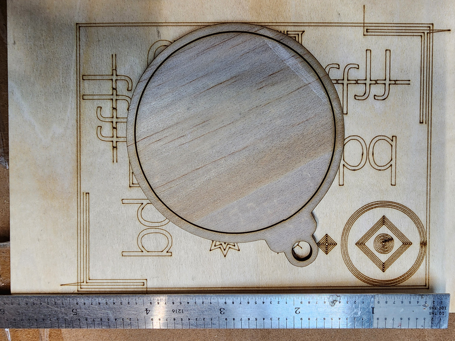

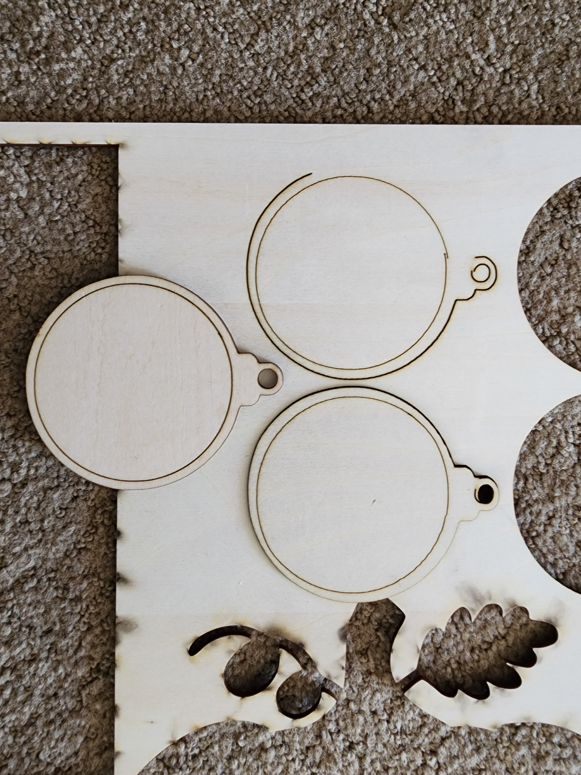

Hey guys I’ve got a diy laser here I just built and having trouble sometimes with accuracy and circles closing etc.
Backlash and all that is not the problem because I can close then start a new file by importing the same SVG and it’s a correct and proper circle again.
Happening a lot more now. Even bought another year of updates and went from 1.1 to 2.0 with the same problem.
Is there something I should be doing differently?

So again, if i restart lightburn i get perfect circles again. the first picture shows a completed blank after JUST restarting lightburn.
Same settings, same file etc. the ONLY thing i changed was i closed then opened lightburn again

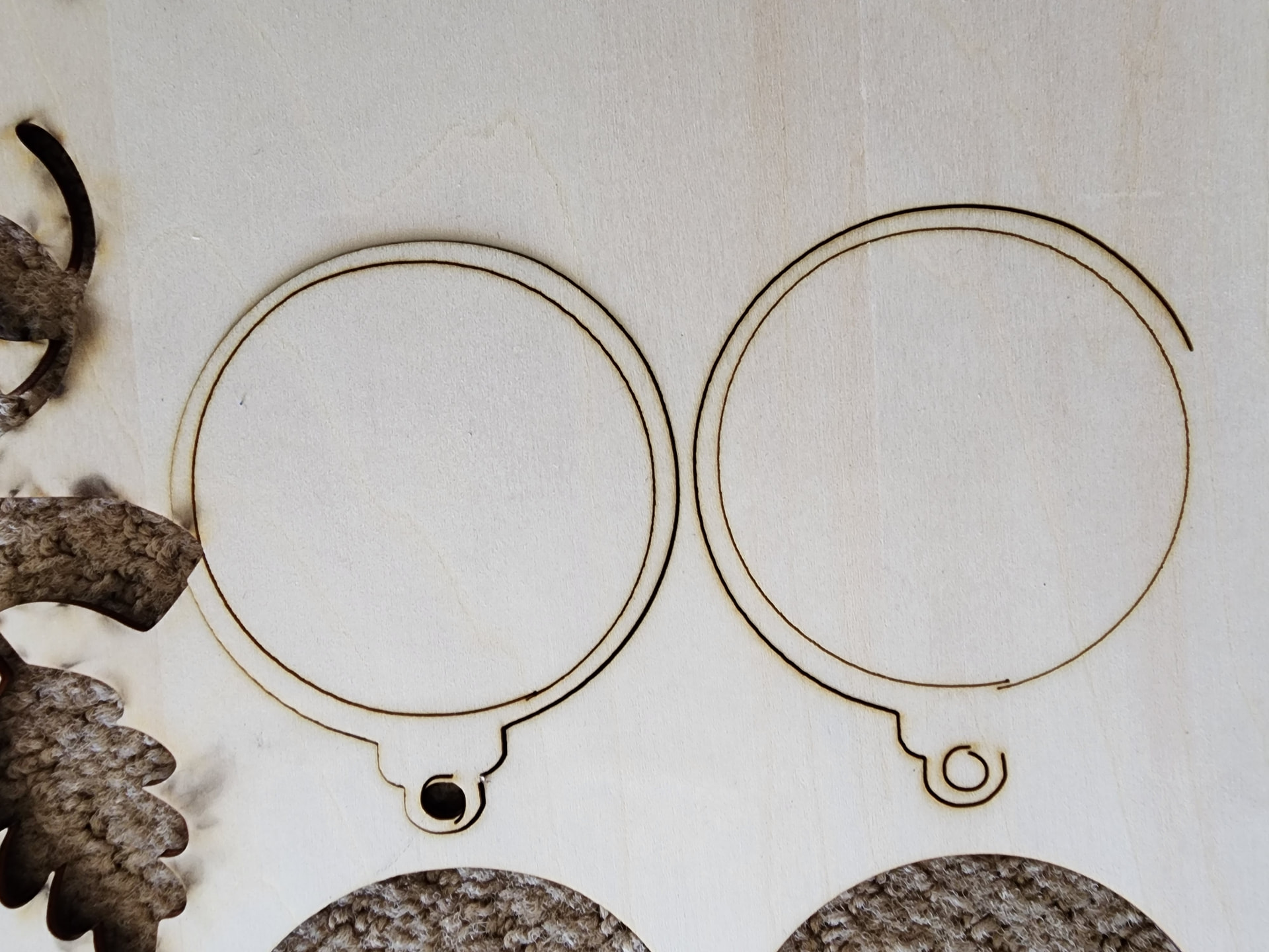

![20260107_155024](https://forum.lightburnsoftware.com/uploads/default/original/3X/0/7/07eb7532c01e34d6f2b4a515d2789d9cc53546b1.jpeg)
This is 50 mm/s which is the fastest I have the machine set to at the moment. The circles for the ornaments are cut at 5 mm/s to 50 with the same result. Sometimes

> [@Sharpen047](#):
> This is 50 mm/s
The point of going as fast as possible is to apply more force to the machinery than usual. If 50 mm/s is the machine’s maximum speed, so be it, but this should be a stress test, not a pleasure drive.
Assuming the Y axis = gantry moves vertically in the picture, the divergence at the top / bottom of this pattern shows the amount of backlash:
 ![LightBurn - circular backlash](https://forum.lightburnsoftware.com/uploads/default/original/3X/5/e/5e41e39ff11a7d7a41897bbc119c70156df4547c.jpeg)
_Assuming_ those circles are a few millimeters apart, then you’re looking for a millimeter of motion due to:
- Loose belt or belt anchor
- Belt slack
- Loose screw on a shaft flat
- Loose motor mount allowing slight rotation
- Loose roller / bearing mounts

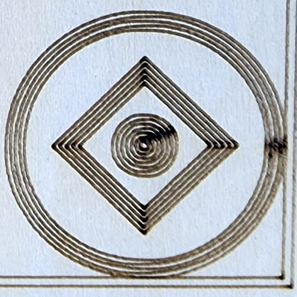

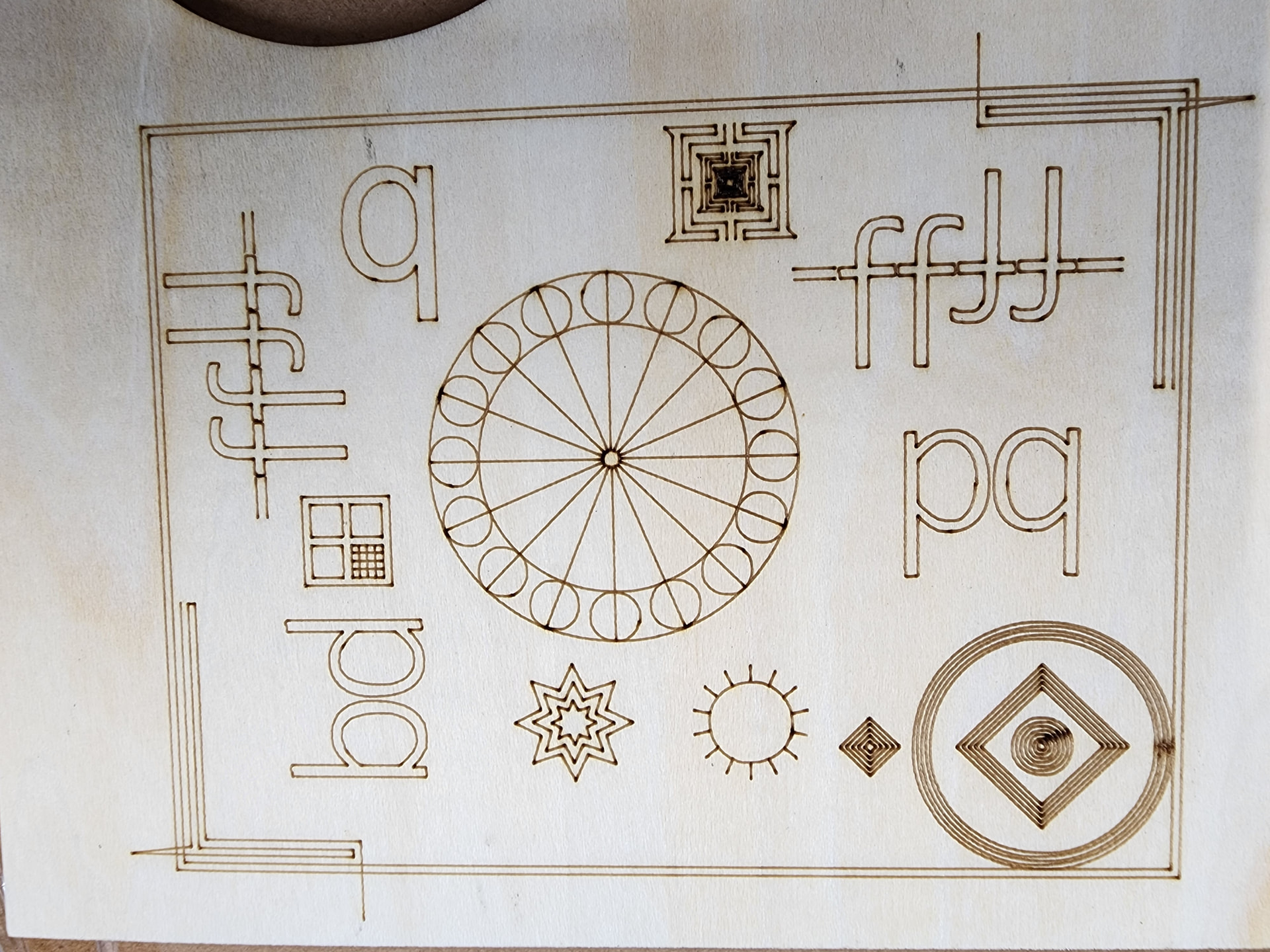

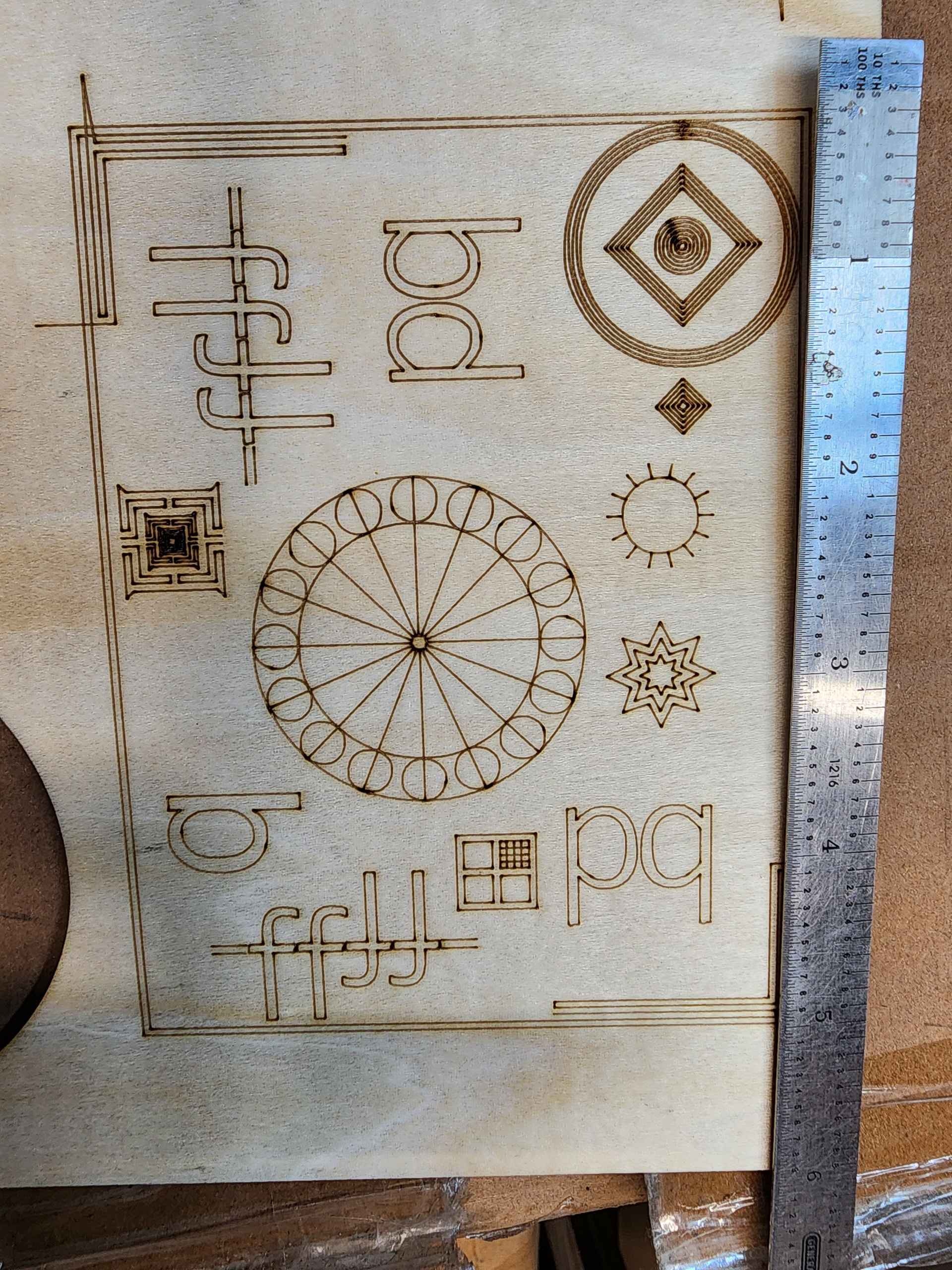

I understand the test. If enough backlash would cause a circle not to complete and touch ends while burning at 5 mm/s, wouldn’t it show up at 50 too?
For context the sample is less than 1.2 inches across.
 ![20260107_171013](https://forum.lightburnsoftware.com/uploads/default/original/3X/8/a/8a4d02a606c8e06b237874836d892674eac16b95.jpeg)
 ![20260107_172505](https://forum.lightburnsoftware.com/uploads/default/original/3X/5/3/53d8219b9a38e2b0390ce4cbd03f18424b9c923c.jpeg)
Trying to show scale to show level of backlash and have a direct comparison to current piece in question
