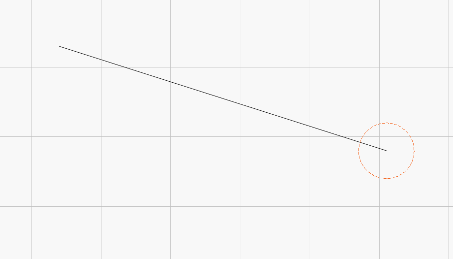

Well I need some help with the circular repetition tool as I need someting very simple. I want to repet on a circular way a line, but with the center at the end of the line, not the center of the line as the tool is doing. It is important for me (end not from center) as it will impact the follow on process.
Could someone help?
Thanks

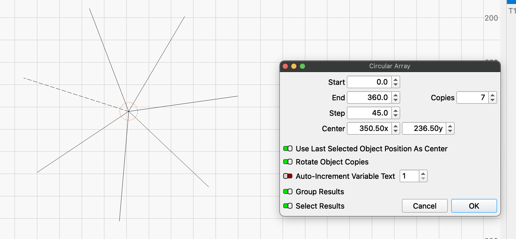

Place a small circle, centered on the end of the line you want to be the center of the array. Place this item on a tool layer so it will not appear in engravings and use that small circle as the center point for your array.
thankjs a lot, it works well.
