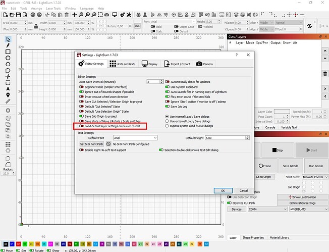

Only problem is that when opening new it opens with default settings in cut but I want to stay with the cut settings I have at the time

Check if by any chance this option is not selected to do exactly that.
I don’t know what version you are using. The image of version 1.4.05 in current versions is in the general settings.
ver 1.708 i am using
→ THIS ← This is the way to keep your settings from file to file.

If you need to keep the file layer settings (not load the default settings) you need to deselect the option contoured as in the image below in software version 1.7.xx
