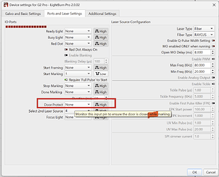

Hi - I’m a new member.
We have a new Cloudray GM100 with the Cloudray safety enclosure. In the device settings the door switch is port 15 and the trigger is set to low. When the door is opened, the laser finishes whatever vector it is burning before it shuts off. We are cutting some simple shapes and this can be a significant amount of time. This poses a serious safety concern that must be corrected before we can qualify this laser for use.
This is in LightBurn Pro 2.0.02

Thanks for the replies. I am also working with the laser supplier to resolve the issue. Kuth, the trigger setting is for the door switch condition and when set to high the laser only runs with the door open. The interlock does function as intended except for the delay in shutting off when lasing a long straight line.
Okay… And where is this setting configured? Through Lightburn software or some other way?
@BeeLaser , please show us a screenshot of the “Ports and Laser Settings” tab in the Device Settings.
I haven’t used a safety door on my machines, but it should be the “Door Protect” port here:

I finally got a response with a solution from Cloudray. They were able to replicate my issue with door protect set to port 15 - low. The laser would finish the vector before stopping when the door was opened. They said the issue was with Lightburn and provided 2 solutions. the first was to use EZCAD2 instead. The second was to set door protect to none and set “Stop Marking” to port 15 high. That is working safely on my machine but opening the door makes the start marking screen go away which prevents resuming the cut (Not a problem for me) and shuts off the red preview trace (somewhat a problem) when the door is open.
