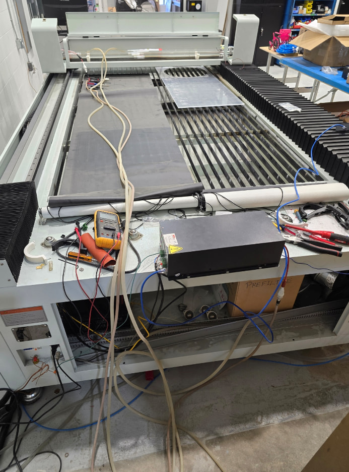

Update and bad news, after a complete flush of the cooling system, having removed all the HV wires (and replaced the cathode wire) and the cooling lines from the machine to have them isolated from each other, NOTHING has change, still get 9/10 an unstable beam like my video above… what’s next?!?!
Looking at what you’ve posted I’d have to remind you how one of these work.
Why it’s intermittently arcing, my little gray cells are still working on that, but I have suspicions.

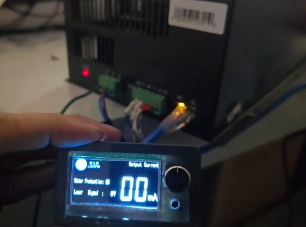

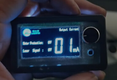

Unfortunately, I now have my old RECI W8 and two brand new MWCLaser 150W, my old power supply, a brand new power supply, tried all the different combination and the problem remains. When using the W8, the result is different, the tube is less noisy, but still unstable, with visible beam leaks around the cathode.
I just played on the power supply, please tell me if it’s normal behavior…
When I press the test button and turn the knob on the ampmeter, it always indicates 0mA, but I notice a small (almost unvisible) beam close to the cathode only, and only when the know is mid range, low range and high range produce no beam at all:
When I disconnect the 6 pins connector, I can now produce a full visible beam, ranging from 0mA to 5mA when playing with the knob, but the power supply is really noisy:
Sometime, always when the 6 pins connector is plugged, the the ampmeter get stuck at 01mA even if I press nothing (see laser signal OFF and water protection OFF even if it is ON):slight_smile:
Sometime, the red light of the LASER stay ON (but dimmed) even if there’s no signal, and it turn OFF if I unplug the 6 pins connector:
Have you tried it with the meter unplugged?
Many people use an inline 30ma meter for that.
Do you have a scope?
:grinning_cat:
I’ll try to unplug it tomorrow!
Yes I have a scope, what kind of test do you have in mind?
Pretty simply, if we eliminate the lps/tube as a probably cause, it’s wise to look at the input signals that drive the lps.
Dsp processors produce a pwm signal the entire time they execute a layer. So whatever you power settings are, it should be reflected in these signals.
The L input or L-On1 is the laser enable signal out of the Ruida and initiates the lase operation.
If you do a line, say 20mm and run it at 1mm/s, it will take 20 seconds for it to complete, giving you time to look at things.
The L input should always remain low if it’s lasing. The pwm should not change.

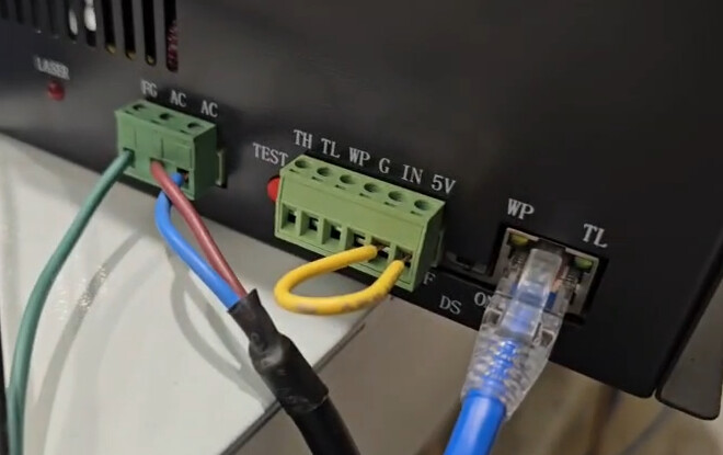

Ok WOW, I might have found something, not the solution nor the root cause but it’s the first time I’m able to produce only GOOD and STABLE beam!!!
First, I bypassed completely the controller and jumped the IN and the 5V connector of the PSU:
Afterward, I noticed that at full dial on the ampmeter (40mA), my beam is perfect, I can even lower the amp and it remains stable. Same result as long I start the beam above about 30mA. If I try the same experience below 30mA, I get back my unstable beam…

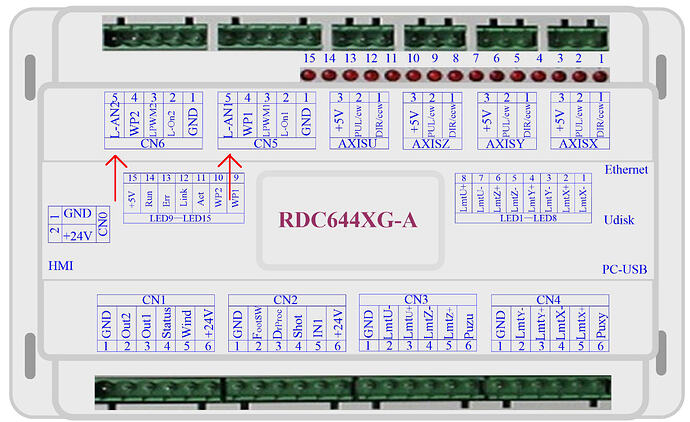

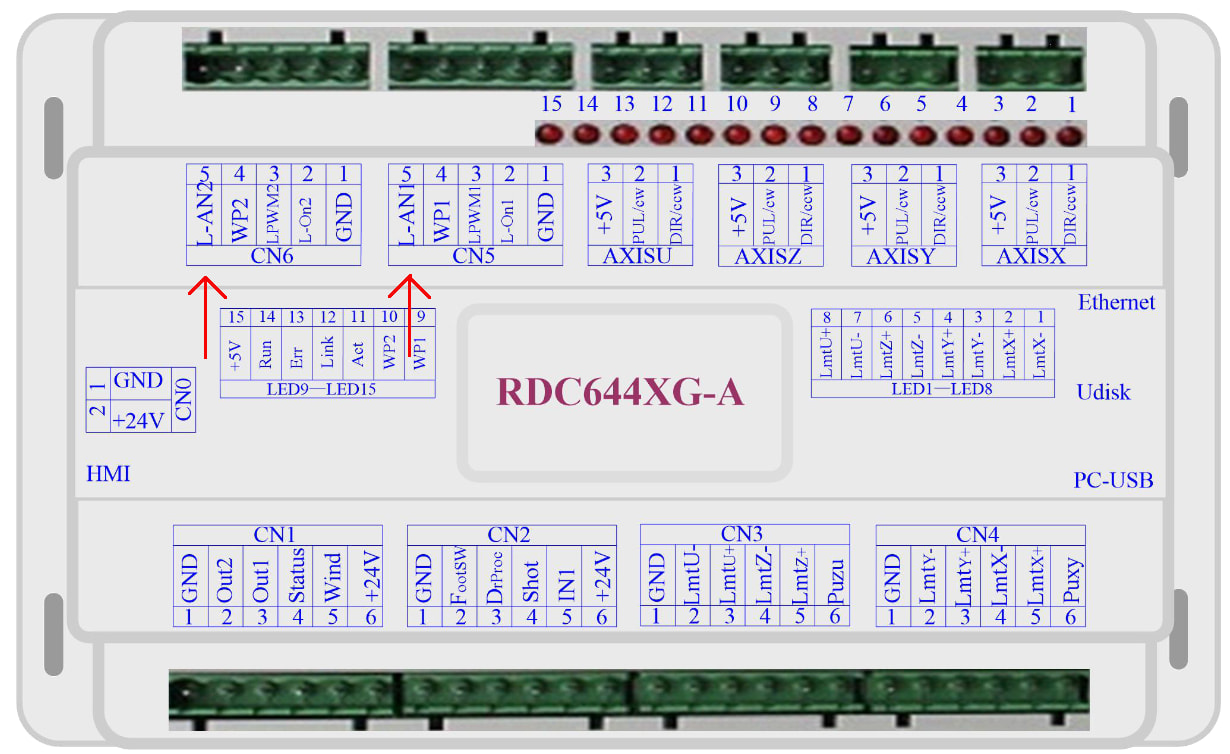

The older RDC6332 can set laser-out analog or PWM digital, before any secondary modulation for content. I’ve not used the analog laser-out functionality myself, I just see it exists in the manual.
The newer RDC644XG dropped the analog function entirely. Since it appears to be meant to supersede the 6332, leaving out that function implies to me there that wasn’t a good feature to be using in the first place. The bar is pretty high to cut an existing function out like that and alienating existing users, which should have been fairly easy to include as an option.
The control I saw is purely PWM to the LPS. The LPS pot is very necessary to establish what 100% power means. I saw a spec of “1ms response time”, and testing shows that it basically the case for getting a full turn-on and turn-off of the tube output. But 1ms to turn on completely/1ms to turn off completely, 500Hz, is not a cutoff frequency per se, it’s the freq where beam power stops being a trapezoidal shape, and transitions to more of a triangle or sine shape The beam power does smooth out entirely to a static analog level at about 2-4KHz. But operating from a PWM in this higher freq range creates beam instability on the low end near the “min power” point and pushes min power threshold higher.

What do you mean by no analog outputs on the 644x series? As far as I know you can unplug a 644x type of controller and stick in a different type of controller like the 6445 type without an wiring changes..
I think the analog output will stay with us a while. I see a number of manufacturers using analog signals to drive the lps.
From the 644x manual, the analog outputs are still there or I’m not following you.

The laser tube and PSU appear capable of working correctly together. When I bypass the machine controller and locally force the PSU input by connecting 5V to IN, I can get a perfect, silent and stable beam, especially when starting above approximately 30 mA. However, when the machine controller is connected normally, the beam becomes noisy/unstable at partial power.
At 90% power in LightBurn or RDWorks, the beam is silent and stable. At 50%, the beam becomes noisy again. Also, if Max Power is set to 90% but Min Power remains at 50%, the beam sometimes starts correctly but sometimes still drops out. This suggests the issue is likely related to how the controller modulates the PSU power input at partial power, rather than a direct tube or PSU failure.
My next step is to scope IN-to-G and L-to-G at 50% and 90% to see whether the controller is sending analog voltage, PWM, or unstable firing signals.
You can look at the controllers wiring and see if it’s analog or digital. CN5-5 is the analog output and CN5-3 is the pwm. It makes little difference what you use, as either, will be converted to an analog voltage within the lps.
