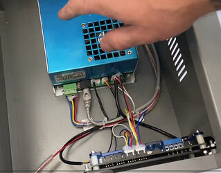

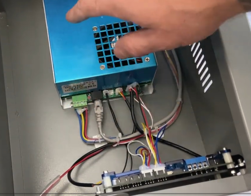

I’d definitely not recommend the Monport one. I was not able to find any picture of the electronics inside apart from a video that is more than 3 years old, but this video showed bad electronics. The only well-designed K40 is the K40+ from Omtech, as far as I know.
This is from the Monport video:
There’s only a single power supply, no safety circuits, etc.

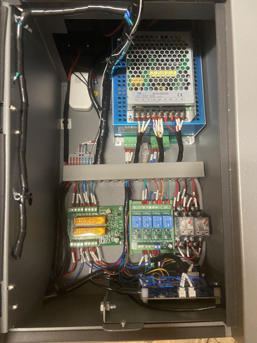

This is the Omtech K40+:
You can see a second power supply for the driving electronics, safety circuitry, and an industry-standard cable management (mostly :wink: )
The blue things, are they relays?
:grinning_cat:
Yes. Actually all of them. The rightmost are high-voltage security relays (I think they called them like this), the middle ones are just control relays to activate IO lines (I think), the leftmost are also relays; they might disconnect all periphery lines. I have to check closer, I didn’t do that yet.
