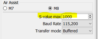

I have a question. I have a sculpfun S30 Ultra 33 W. But I think my $ codes aren’t correct.
Because when I want to cut something I have to set my speed to 5. But in the parameter of sculpfun stand that it can on 960 speed.
I have served on the internet but I can find the problem.
can someone help me?

Can you type in $$ in console and copy paste here?

Does $30=1000 match S-value max in device settings?

Yes, I have the same settings as the screenshot

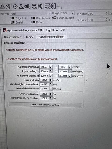

or is something wrong with this settings?

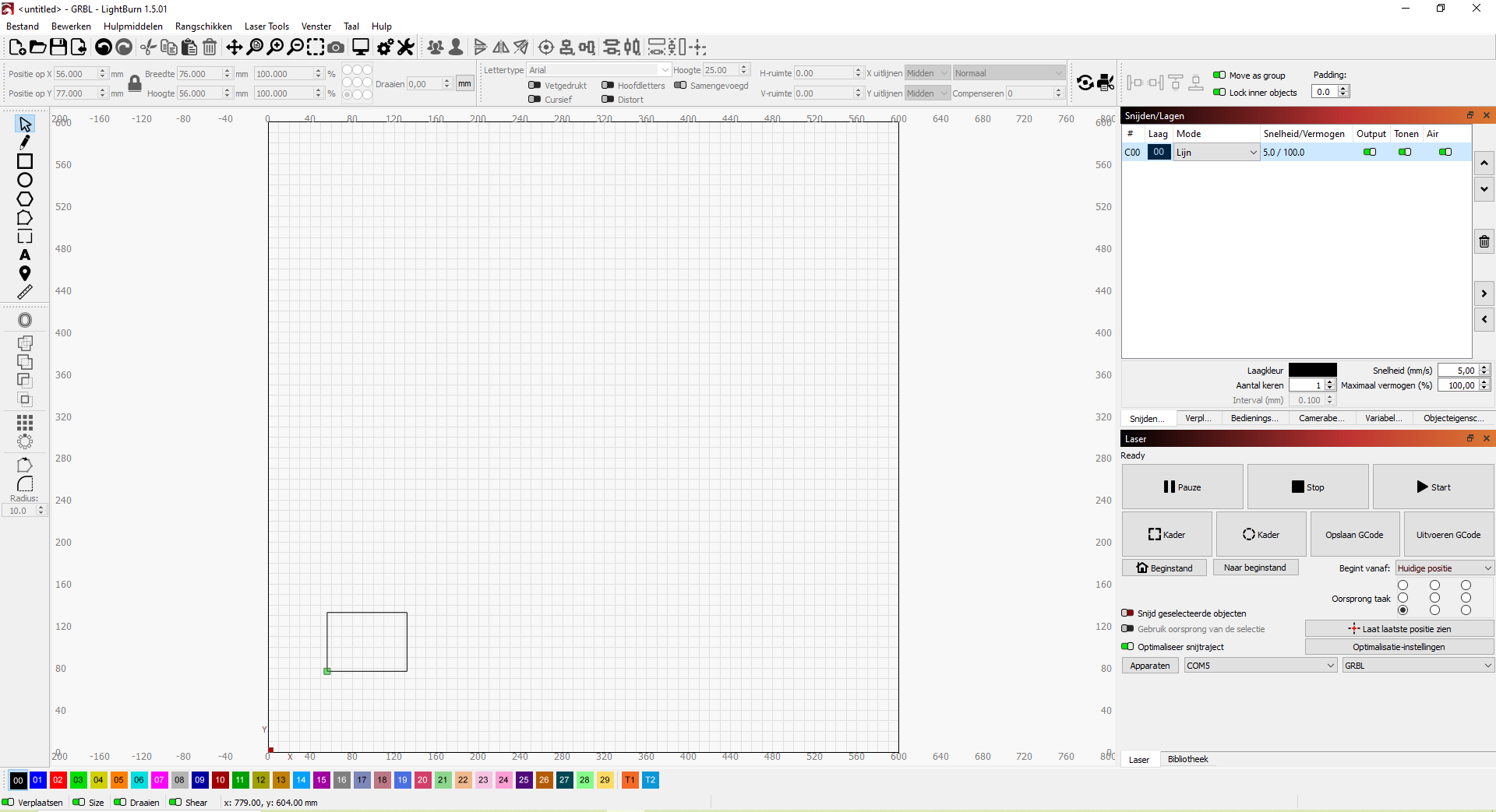

No, those settings do not effect the laser. Show a screenshot of the full LightBurn window, including the laser window.

![image](https://forum.lightburnsoftware.com/uploads/default/original/3X/5/a/5ac7ea9e3e693c63f47d3de9542a55c0c557f0a3.png)
do you mean this

Exactly. This shows that you are using mm/s as speed units. Your results are perfectly fine and expected. If you want to compare your settings with Sculpfun recommendations and the rest of the diode laser world, change this to mm/min.
