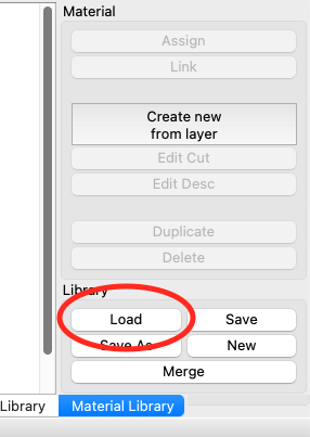

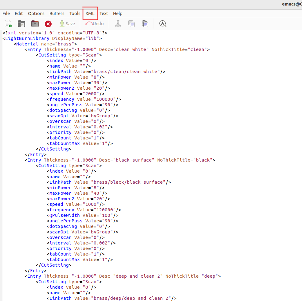

Thank you very much. I tried opening your file with a couple of robust viewers, but I can’t. Do you have this in a more common format, like xml perhaps? Sorry for the inconvenience. I would be grateful to have them.
It’s a Lightburn Materials Library file. You don’t open it. You Load it into Lightburn’s Material Library.
Not too robust as it’s just a flat file.
When loaded into Emacs, it’s detects the file as XML and changes to that mode (red outline).
