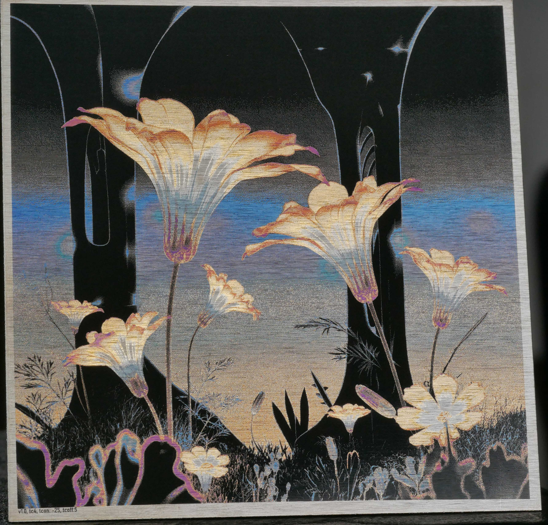

Hello! I’ve been working on printing color photos/raster images on titanium and steel using a 60w MOPA fiber laser with a F290 lens. First, some sample works on titanium (TC4/GR5 alloy) 10cm x 10cm plates. Illustrations:

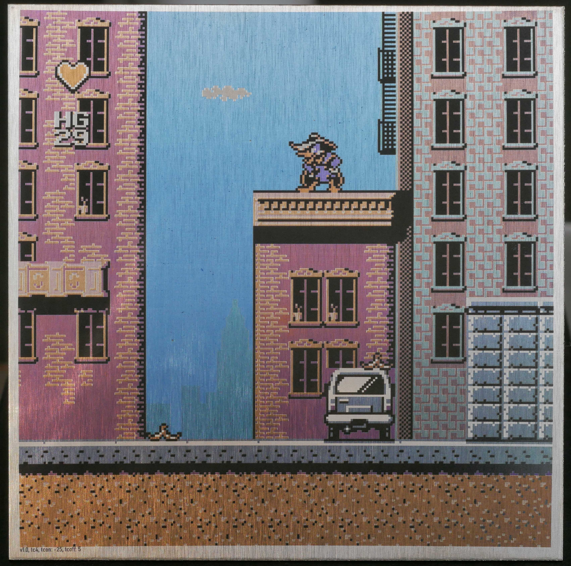

It works great for pixel art, a screenshot from an NES game:

The process is not too complex, first quantize the colors of an image to a limited number or use a specific palette to remap the colors. Then dither/halftone it (this is optional, for example you don’t need to do that for pixel art), split the image into b&w images of each color and engrave all of them. For quantizing and dithering/halftoning you can use your favorite image editing software or some specific tool such as Ditherista.
I couldn’t find an easy way to split images so I wrote a Python script to do that, you can download it here. It requires 3.x Python, the PIL and webcolors Python modules to be installed. It is not hard to use and has some additional simple functionality besides the color splitting, such as upscaling, outputting the color palette and more for convenience. Here’s how you use it for an image named dith.png that you’d engrave using 635 DPI (0.04mm line width):

It will write separate images for each color into the same folder it is run from. Add them to a Lightburn project, set the correct physical size for each image as specified by the script, turn on pass-through mode for each of them and set the frequency/speed/power/pulse width parameters for each image for specific color.
I have to note it is not easy to find a decent color palette using just one line interval that looks good on pixel size scales, but it is possible. I’ve been working mostly with 0.04mm line interval (635 DPI), on titanium for 0.04mm low speeds (40mm/s - 200mm/s) and low power seems to work best. If you have worked with color engraving on steel or titanium you probably know you will need to do a lot of material tests to discover the colors. Calibrating the timing settings (TCON, TCOFF) helps a bit but is not essential, just stick to the same settings you do the material tests.
I’ve attached two projects if you want to see how the printable projects look like, though you will definitely need to modify the settings for each image to get similar colors, unless you have an identical setup.
