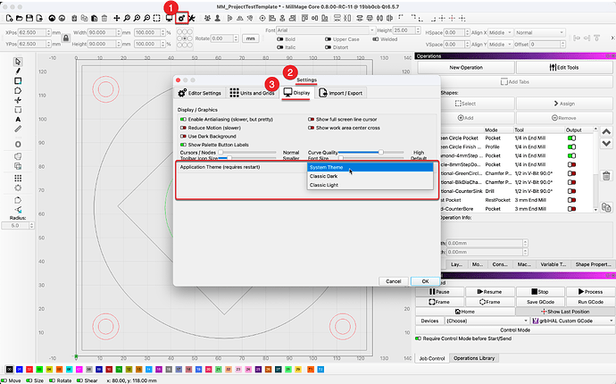

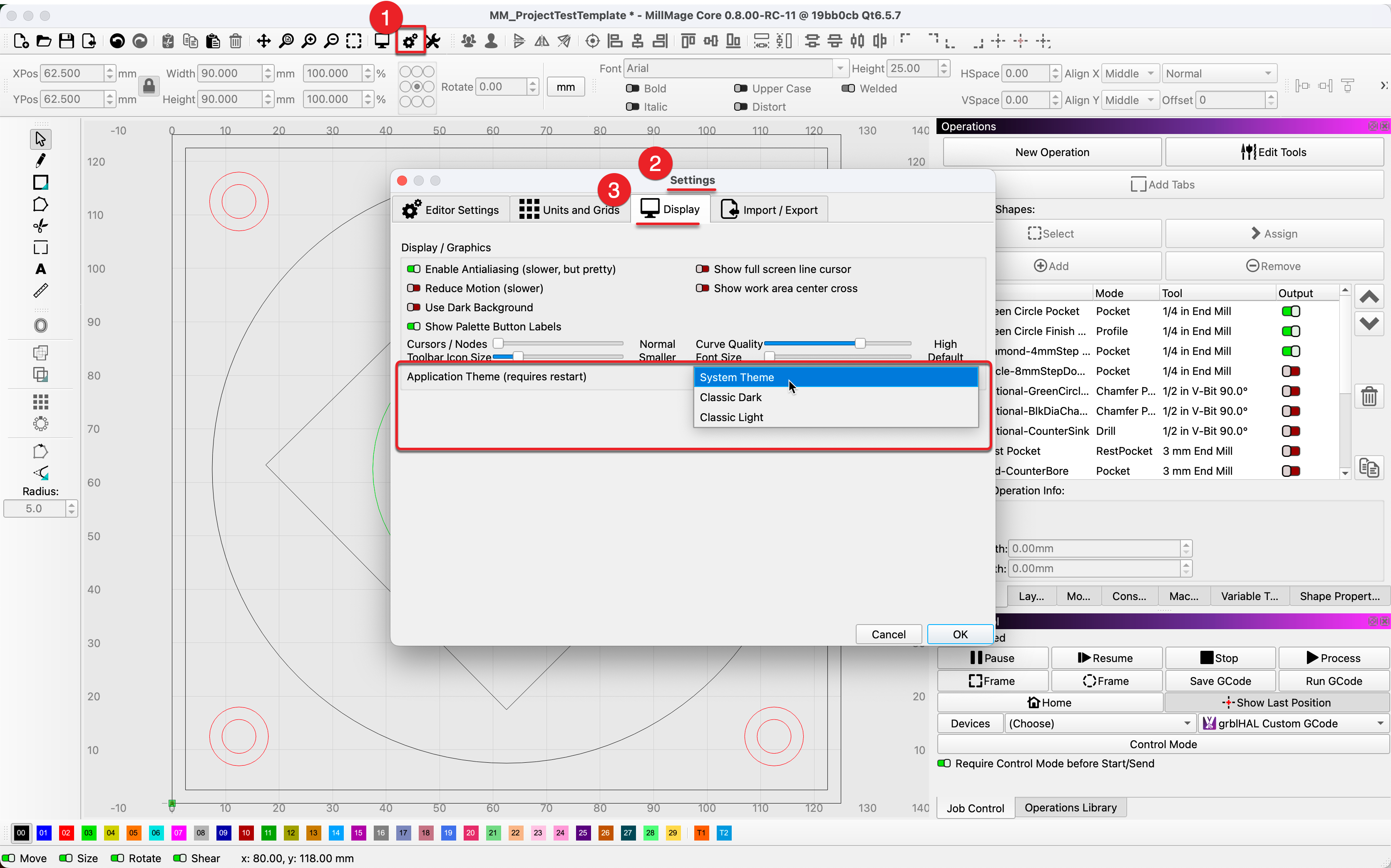

That would be nice. because my entire Millmage is dark like it’s night use or something.
But on another computer it’s normal. I think I toggled a dark-thing-a-ma-bobber button and don’t know how to un-toggle the dark-thing-a-ma-bobber button lol
There have been some significant improvements in our abilities to create custom themes for LightBurn and MillMage with the recent upgrade to the QT framework we build upon. So, in short, yes, this sort of thing is doable. I’d recommend posting to Fider so we can keep track.
You can find the ‘thing-a-ma-bobber’ here. :slight_smile:

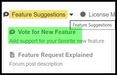

Dont know what a FIDER is…
It is where you add your feature request
https://lightburn.fider.io/
See link to it on top right of screen
THANKS !!! I’m already half blind so that was a huge help!
You are welcome. And for future reference, it is officially called the ‘THEME-a-ma-bobber’ button. :wink:
THEME-a-ma-bobber’ button Got it!!! :rofl:
