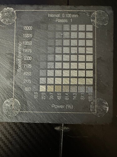

Comgrow Z1 - Engrave consistency - Assistance Needed.....again

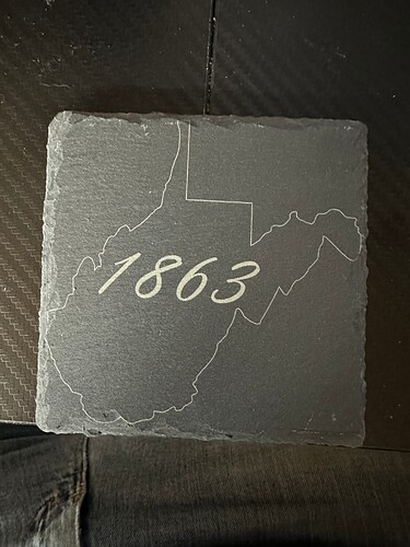

What do ya think?
It’s different, but I wouldn’t call it good yet.
Left belt wasn’t tight enough to maintain contact with the stepper teeth
It looks like the farther away from 0 you are the worse it gets. Maybe it’s just how it looks in the picture. There’s still a little play somewhere.
Yea, a little. But here’s the first engrave post fixing
Note: Numbers are tilted on purpose
It definitely is better. The first pic in the thread though, you weren’t in fill mode on the 1863. I still say you have some slop. After you get all the slop out, the next thing you need to do is work on scanning offset adjustment to clean up the edges of the engraving.
Ultimately it’s when you’re happy with the results that matters.
  1. Scanning Offset adjustment?
  2. I get what you’re saying. But let me paint a picture for you. This is the first fill that has come out looking good.EVER. So your help has gotten me so close to where I can be happy with it
For your reading pleasure. I’m happy to be of help. Scanning Offset Adjustment - LightBurn Documentation
