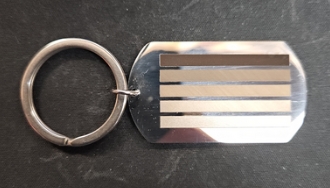

I recall there was a bug for certain boards in grayscale mode in an earlier version of Lightburn, but it seems that was BSL specific. Can you run the test file posted here: [Photo engraving on stainless steel in grayscale - #18 by NicholasL](https://forum.lightburnsoftware.com/t/photo-engraving-on-stainless-steel-in-grayscale/166249/18) and show the results? Or post pictures of your settings, a file you are trying to engrave and a photo of the results? (or both!)

I used the settings you had and here’s the result.
 ![001](https://forum.lightburnsoftware.com/uploads/default/original/3X/d/8/d8faa94284c1e5ba19c35865930c299ee9941bdd.jpeg)

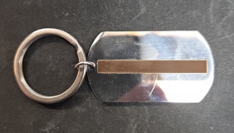

I did a second burn using the settings I have. These shades were determined by speed and frequency.
 ![002](https://forum.lightburnsoftware.com/uploads/default/original/3X/e/f/ef17c24a74ce07d4a50c3cd2266d4eb3e24c48f3.jpeg)
I’m going to say that this is a limitation of my laser and leave it at that.
