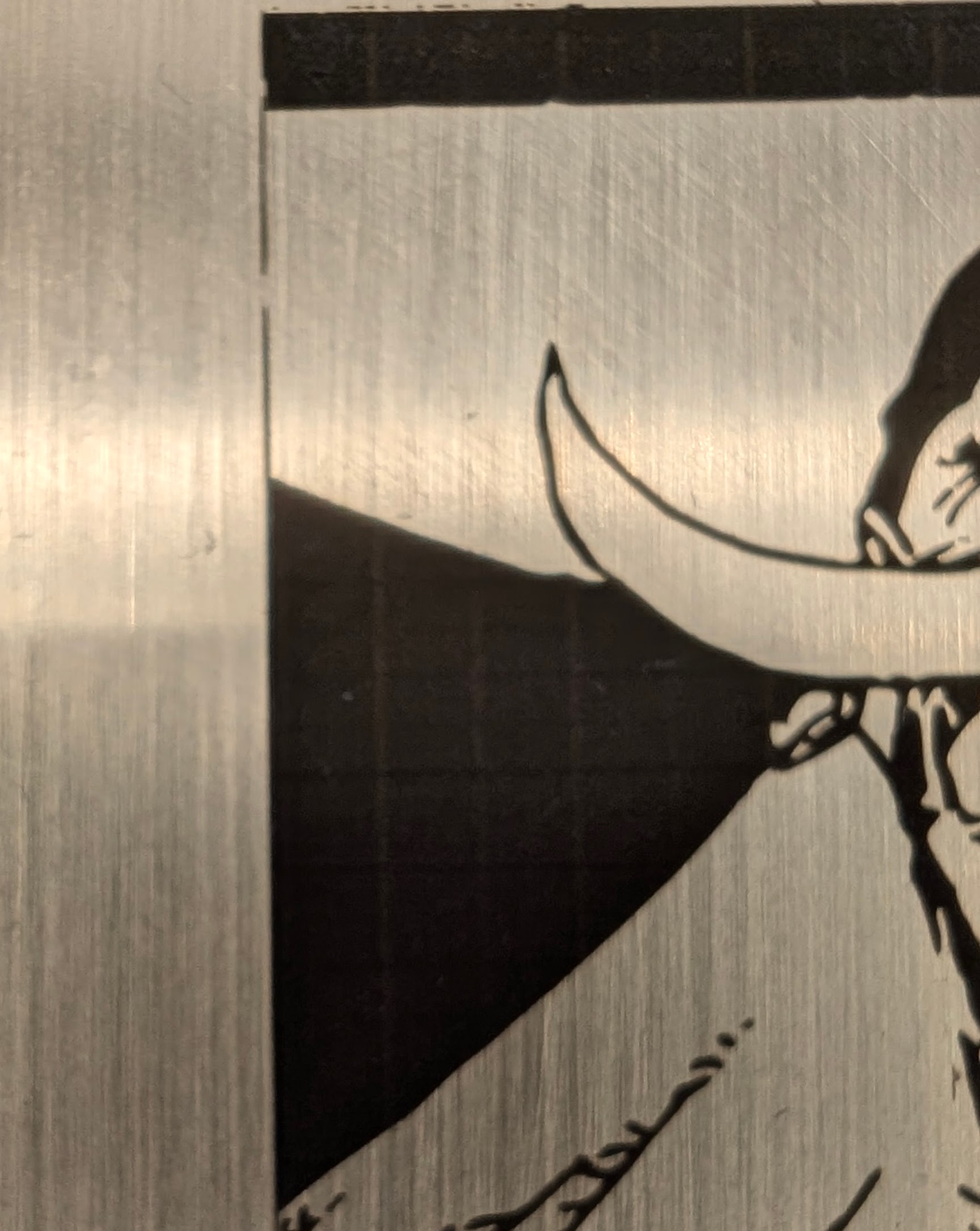

Now I have a Commarker B6, 60W MOPA (with an F210 lens and a 150mm x 150mm working area) and for years, I’ve managed to silently follow along, but now I have a problem I’m not quite sure how to solve: a visible “grid or pattern” in engravings.
I mainly wanted to engrave brushed/ground brass. The grid is sometimes more, sometimes less noticeable depending on the depth of the engraving. It’s most noticeable right in the middle of the working area (like centering a cross).
I don’t know if this helps with identifying the problem, but the rectangles are 2.5mm x 2.5mm in size.
Settings: 1500mm/sec, power 55%, 450 kHz, 13ns, line interval 0.002, 1 pass, scan angle 0 degree:

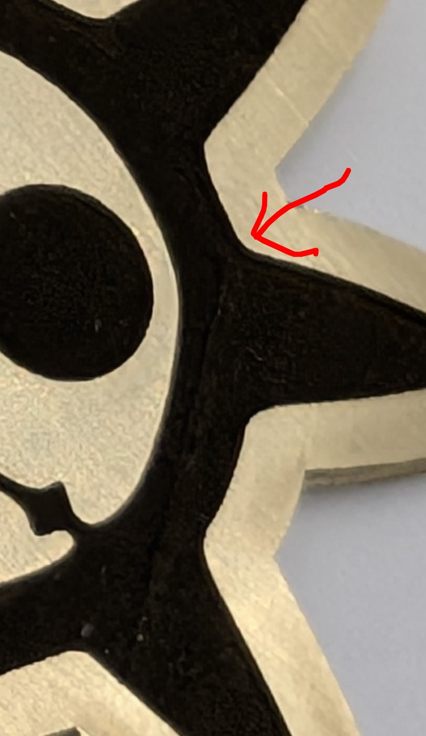

200mm/sec, power 95%, 60kHz, 200ns, line interval 0.025, 4 passes, scan angle 45 degree:
With the deeper engraving you can clearly see and feel that the engraving is less deep.
The pattern is most visible when I use scan angles of 0, 45, or 90 degrees for a single-pass engraving, and is no longer visible if I use a scan angle of 6 degrees, for example.
With deeper engravings the lines are always visible.

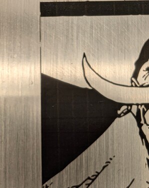

Scan angle 6 degrees:
