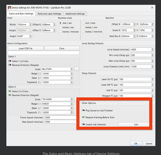

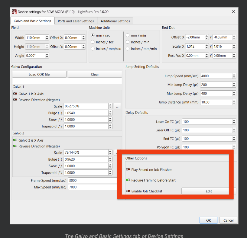

Pressing the start button will always open the framing window if the setting for it is enabled in your settings:

That setting is disabled yet it still frames when start is pressed

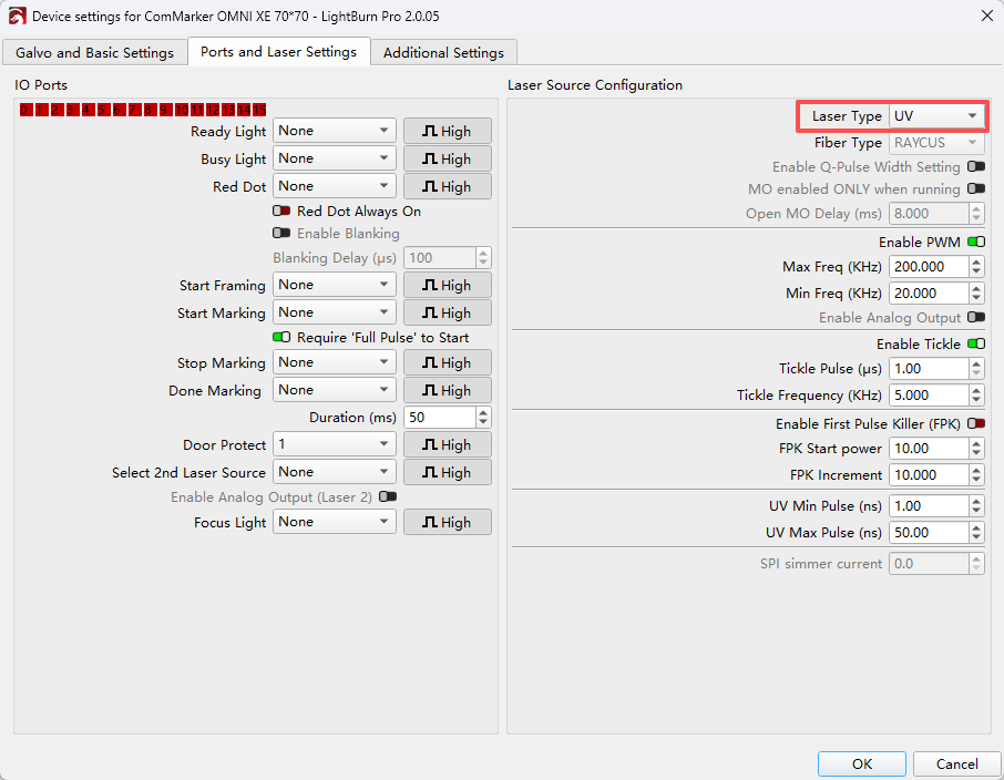

Your settings look like this for starters? Does the laser work with the Commarker studio app?
