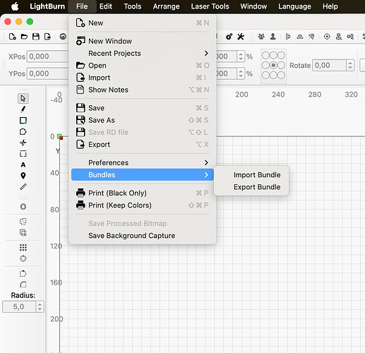

Hi, total novice. I have a desktop computer at home with internet. The laser is somewhere else without internet but with a laptop.
If I install Light Burn on both computers, can I transfer objects from the desktop computer to the laptop with a USB stick to be able to use the laser?
NOTE! I can install LB on both computers with my internet at home.
Yes, you can do that without any problems.
A little tip, use a “bundle” to make 2 identical setups, i.e. you copy all settings from the machine you use primarily with the laser with LightBurn’s bundle function and import the same data back into your “construction machine”. Save the files on both machines and use the same library setup on both computers, it makes life easier.
