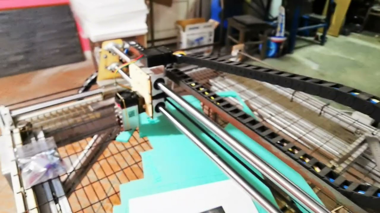

Hi.
I have problem to conect lightburn and MKS DLC 32 v2.1 its olvays a masage:potr fail to open alrey in use.
i doo new WIN 10 and new BIOS its same on all usb ports ist recognize bat no conection.
