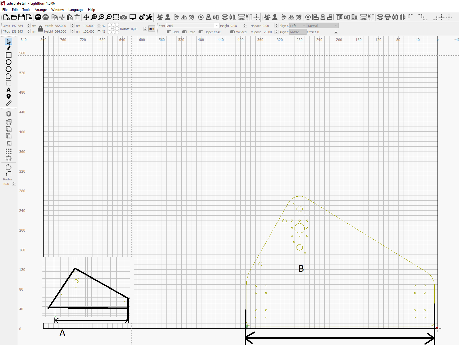

Everthing is working fine but to get from DXF to Gcode is a big of a hassle with inktscape and the well known plugin thats why i wanted to try light burn, but i’m running in some strange problems. the size that i burn is way smaller than with laserGRBL and everthing is in mirror and i can not find the solution to my problem, can any one point me in the direction to solve it? ik using a arduino one board with a breakoutboard with steppers on it in 32microsteps mode, i’m thining i need to find it there, a do not want to change my settings in my arduino board because with laser grbl everything is working fine

the biggest problem still is that the part that I burn or cute is way smaller than the actual thing, if i look at the size in lightburn everything is the correct size but not when i burn it.

if you take a look at the screen, B is the actual size and A is what i get
i’m speaking actual size wise. if B would be 400mm then a would be someware like 75mm
You’re saying that the item that you burn is A right? So what you burn is actually coming out smaller than what is in LightBurn? If so, this is almost certainly a configuration problem. Possibly where GRBL is setup in inches.
