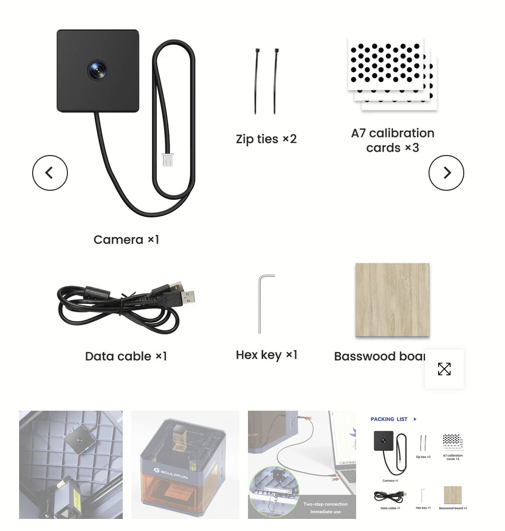

Do you have this Sculpfun iCam, and are you following their video instructions [here](https://www.youtube.com/watch?v=nJypFkjGeMs)?
 ![image](https://forum.lightburnsoftware.com/uploads/default/original/3X/e/3/e37bf8a87f03b88c003286006bfbc7c7e8475e8e.jpeg)
That would explain why you don’t see the same settings. 🙂
In later versions, we default to using the [AprilTags calibration card](https://docs.lightburnsoftware.com/latest/img/CalibrationTags.pdf) and dropped the old dots pattern that Sculpfun ships with the camera.
Here’s a scaled down version of the calibration card that I think will fit well for the iCube:
[LightBurn\_AprilTags\_25percent.pdf](https://forum.lightburnsoftware.com/uploads/short-url/ifOo45Rf66jmL7wxI07cdP6AWbK.pdf) (7.5 KB)
You still need disable the safety door as instructed in their video, if you haven’t done so already:
Enter this command in the Console window with the laser connected and press enter:
`$SAFE=0`
Then, follow our youtube playlist instead to Add the camera, calibrate the lens, and align it to the workarea:
 ![](https://img.youtube.com/vi/atQXSLrm_AU/maxresdefault.jpg)https://www.youtube.com/embed/atQXSLrm_AU?feature=oembed&wmode=opaque&list=PLN-loosFETNk
I’m looking forward to hearing how it goes.

Hi Aaron, yes what you posted is the setup I have. I will give your instructions a try and see how it goes.
