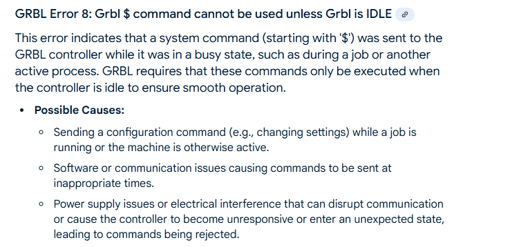

So if I power up my machine then boot the PC, then load a file when I try to jog into position it will not jog. I get an error 8 …
Even though the machine has not started or doing a job. Making a bit fustrated. what would cause this? How much MORE idle can a machine be on fresh boot up?
Try just pressing the stop button once before starting anything else. This will reset the operation status of the laser.
These machines seem to have a mind of thier own some days. I got this machine fixed but I can not say what the problem was, as I dont know. Pressing the stop button did not help. I removed machine from software,
I powered off machine and PC. Unplugged all cords, power and usb, overnight. The next morning I added machine. Set up again and still not good. Then out of no where it started working.
