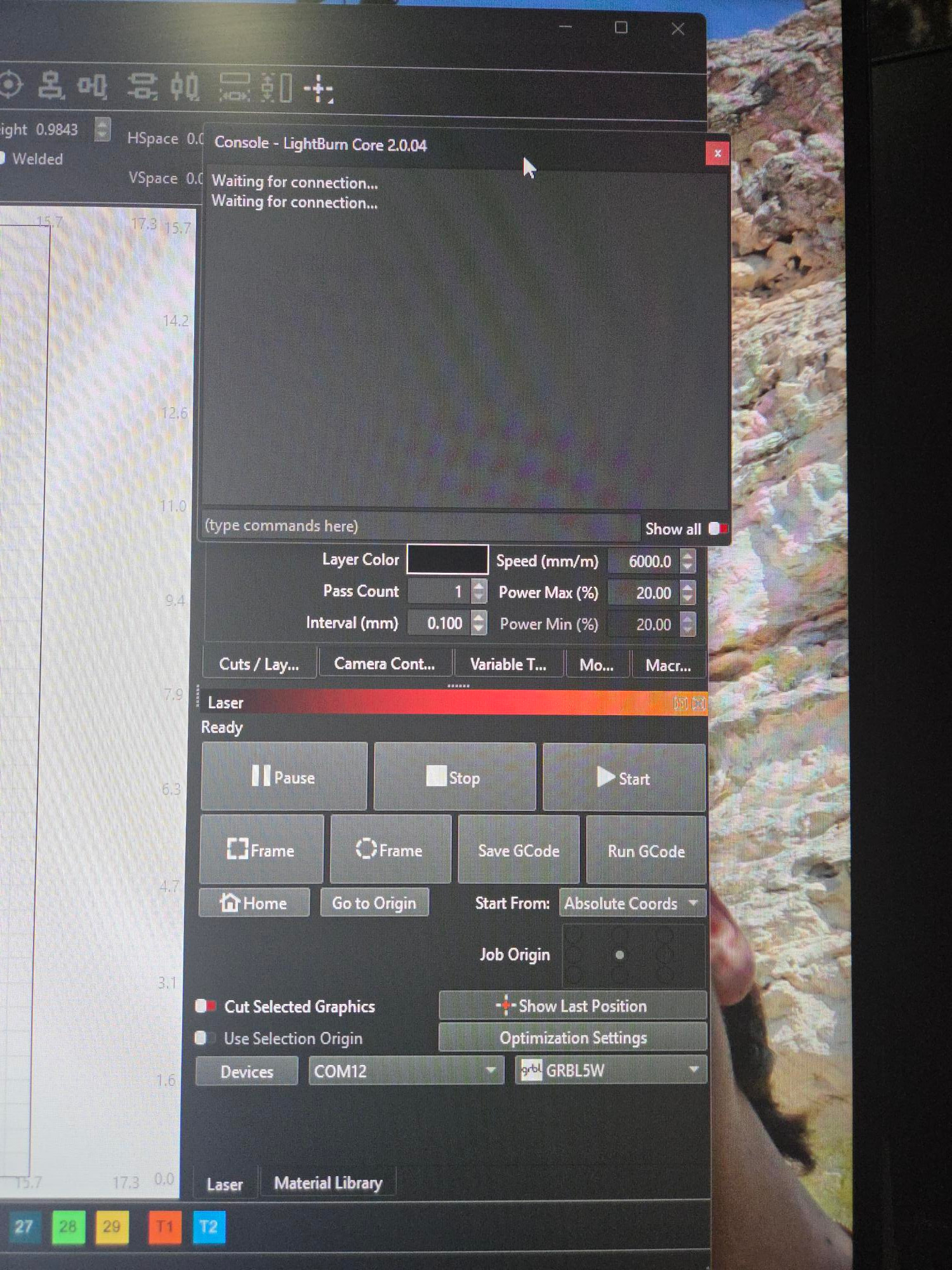

I have a 5W COMGROW laser and it works fine with LaserGRBL but when I try to use it in lightburn all I get is Waiting for connection and never connects, I have uninstalled and installed lightburn a couple of times and still nothing happens this is the steps I have taken, I am using a PC running Windows. The only device is this 5w and the only Com is COM12. I dont know what to do next.

It may still be connected to LaserGRBL. A serial device can only be connected to one software at a time. Turn off the laser, restart your computer, Do NOT open LaserGRBL, open Lightburn and see if it will connect. Oh, and you have to turn the laser back on too.
Good Morning, I downloaded lightburn on a laptop that the laser has never been hooked up to and never had lightburn on it and it says ready but under Console in lightburn it says waiting for connection, Please see the picture, The laser was off all night and like I said the laptop has never had lightburn or this laser hooked to it before. Not sure what a TF Card is but it doesn’t exist.

It’s not entirely clear if this message is actually coming from the Comgrow laser, or another serial device attached to your computer.
Try another COM port if you see one in this drop down:

There is only 2 ports on the laptop so I switched it to the other port and this is what I got. Same thing
LaserGRBL is not open at all, You think I need to restart the laptop after I installed lightburn?
Does the COM3 port disappear in LightBurn if you unplug the laser?
If it doesn’t, it’s not the correct port, and you might be missing a USB driver.
Get them from here:
While my laptop is restarting I tried it again on my PC and when I unplug the cord from the port it disappears and when I plug it back in the port shows back up, But it still says Waiting for connection
On the laptop when I unplug the cord from the port the Com stays there until I click the down arrow next to it and then it dissapers,
Great. That means, it’s the correct port.
Did you already try the Find My Laser feature when adding the laser? - Not every device can be detected this way, and it might have been necessary to add it manually like you did before.
