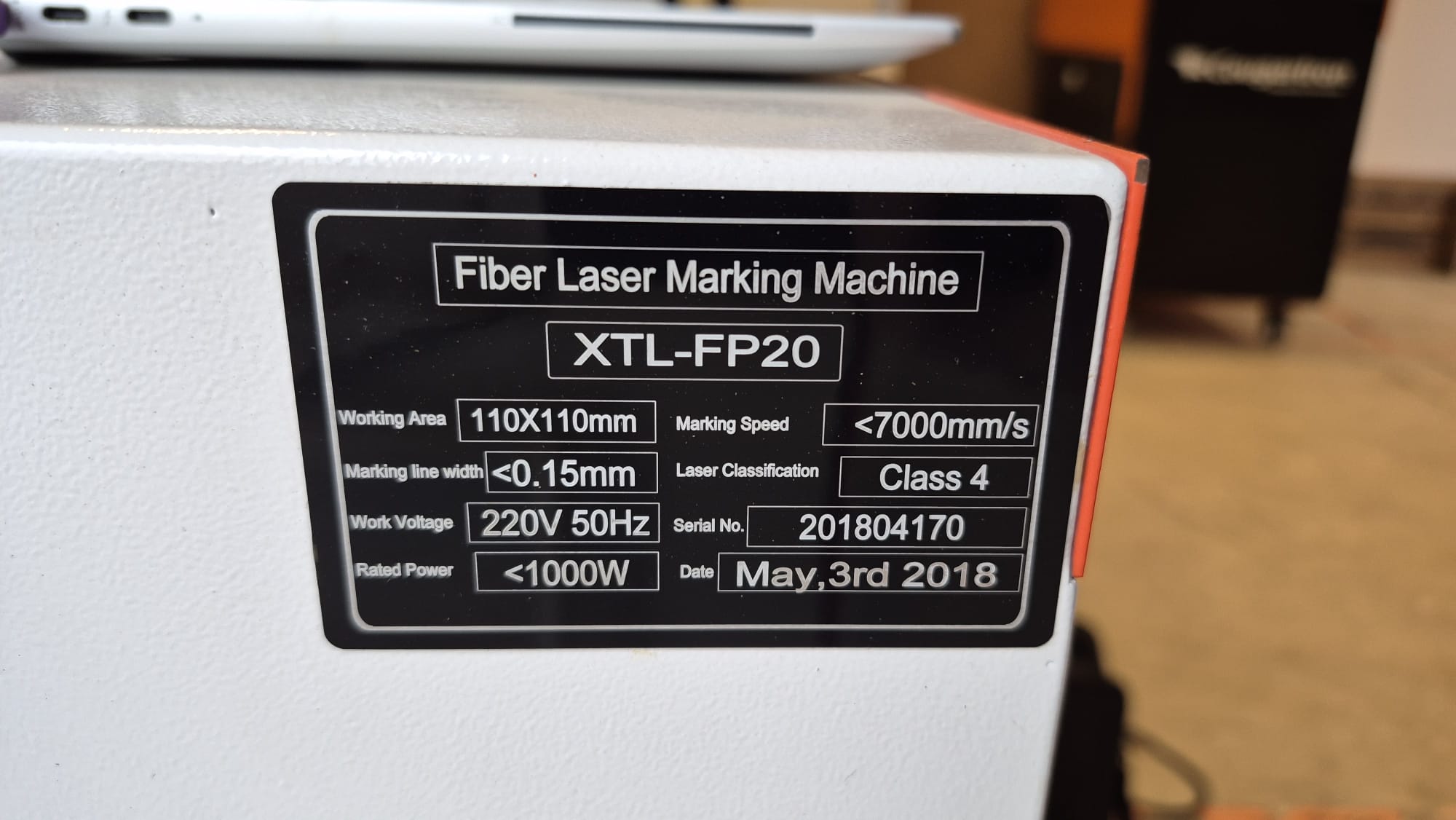

I have a 2018 XT Laser laser marking machine, which I am trying to connect to Lightburn.

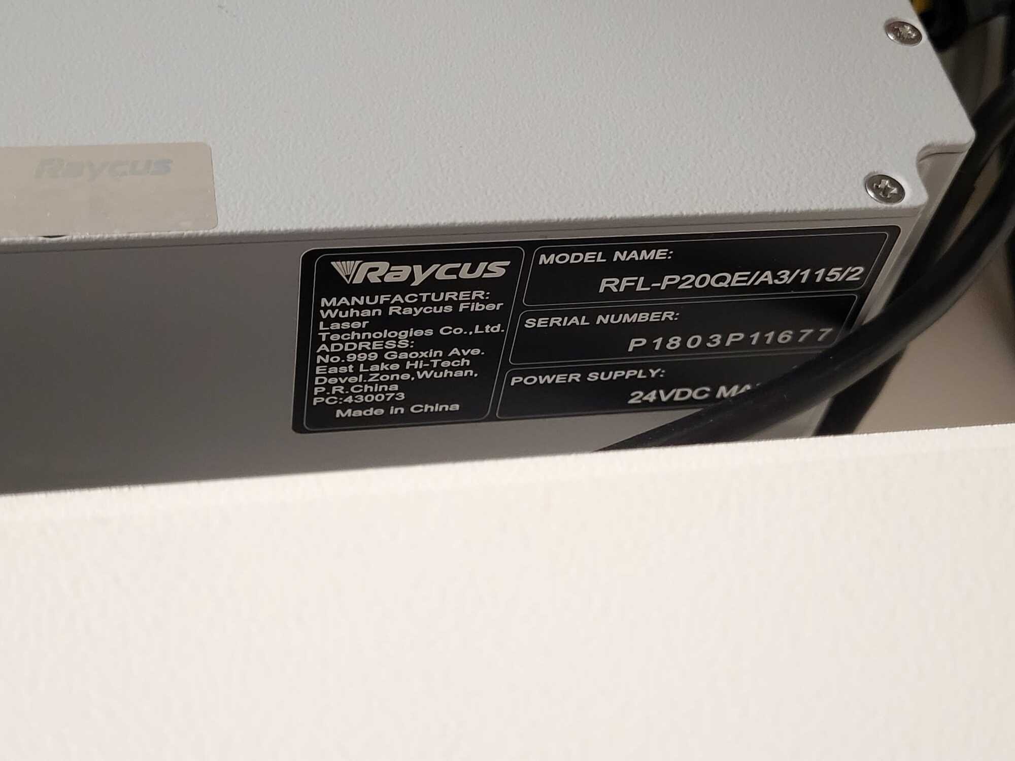

The laser source is Raycus, and it currently works with an old Win7 laptop using Ezcad2. However I am trying to get the laser to work with a Lightburn Pro demo version on my Win11 laptop.
I have installed the JCZ driver, and the laser shows up correctly in device manager. I have added the device in lightburn, it won’t find the laser on scan, so I added it manually, choosing JCZFiber, and importing the config file from the old Win7 laptop.
However the laser still shows as disconnected, can you help?
