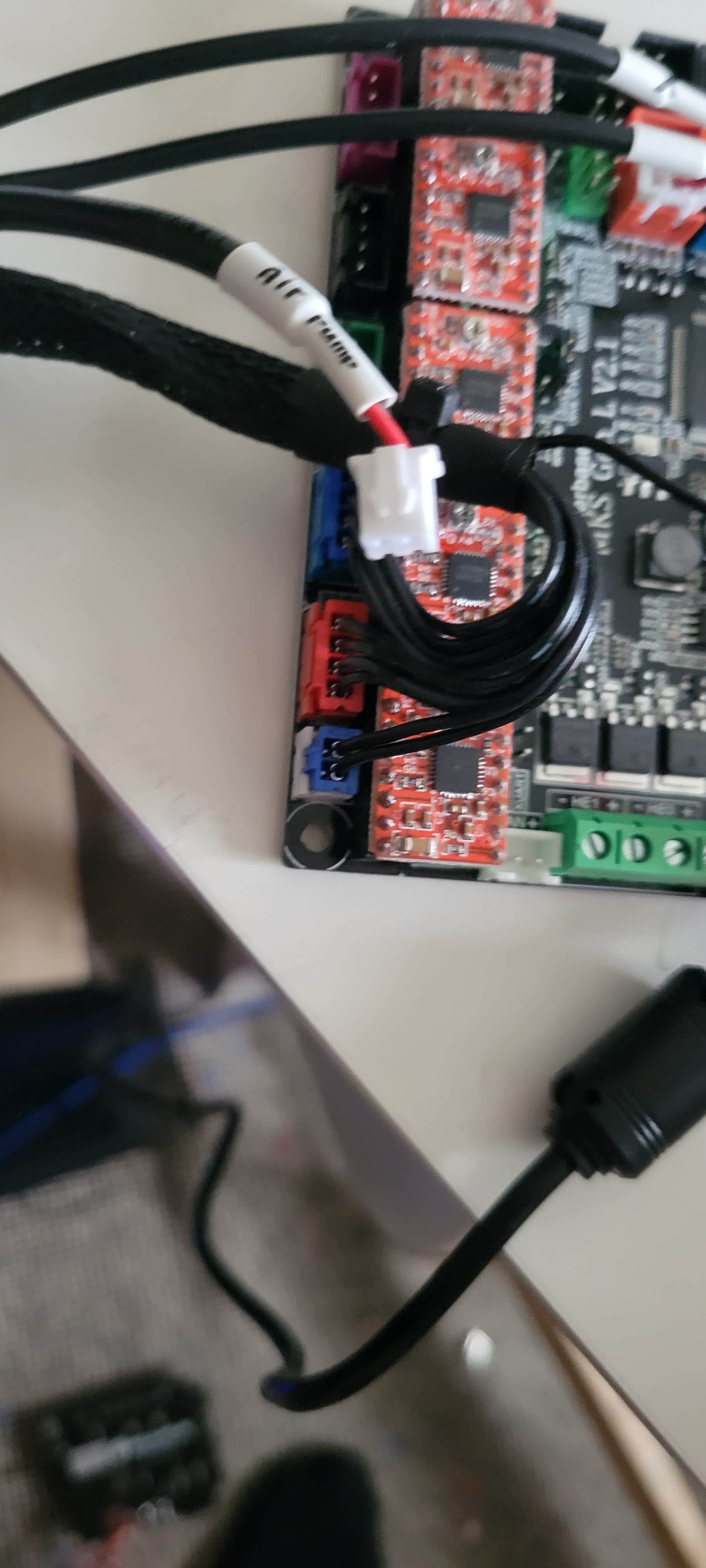

One last detail is with this board Im not sure where this plug goes. Its the only one I have without a spot. Ive read through so many diagrams but Ive had no luck finding any answer for this one wire from the laser. (2 pin red connector in my hand)
The board:

Is that from the laser? Where does it connect to? So it’s a 2-pin connector with only 1 wire?

There are no connectors for your plugs because it’s a different board design. You need to change the cables / connectors to make it fit.

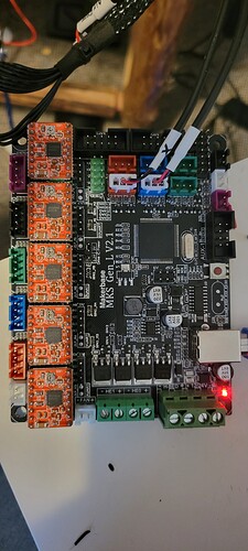

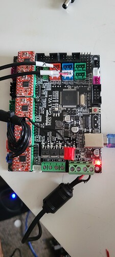

There are connectors that fit into place, at least it seems to. See picture below:
Also note: the air fan plug in the second picture is not plugged in. Thats not the single pin red connector I reference above.
If the type of connector fits, it doesn’t mean that they should go into those plugs. The three wires of the laser module are power (the two-wire connector) they need to be connected to 12V. The single wire is the signal wire, it needs a 5V PWM signal from any pin where you can send a PWM signal to.
The air pump wire can be connected to one of the bed or HE connectors, I think they supply 12V which the pump needs.

Got it. The position I have the 2 pin connector in is a 12v and gnd recpet. I think, i say with hesitancy, is correct. The remaining red i can get 5v to easily however its a constant which keeps the laser on at all times. My thought was that its a signal wire but without knowing which position on the board sends that signal, I dont know where to put it.

Typically for 3d printer controllers PWM is connected to either fan or heated bed connectors if a more appropriate source does not exist. One challenge is in making sure the PWM frequency is adequate for laser operation. You want this to be at least 1KHz.
