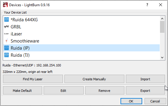

Silly question but, is there a way to “import” a machine configuration as well as settings into Lightburn.
A method that would be GUI based rather than drill into the folders structure
We could attach config presets maybe?
This way we would bypass that mm/min mm/sec issue as well we discussed earlier and mostly have a default for Ortur machine preset
EDIT: Maybe in the start wizard, add a Import button that would allow it?
You can Import / Export from here.
Will it also import Lightburn settings?
Thing is at that stage user already went past the wizard, at first use.
This imports only the settings for the device itself, and the latest versions of LightBurn start the user on this screen, not the automatic finder.
