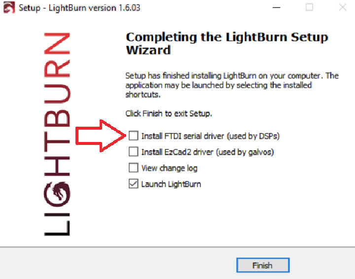

I woke up this morning, turned on my laser and laptop, opened LightBurn, and it won’t connect
I have been using the same Ethernet connection for 2 years without issues
Troubleshooting:
checked all port connections and cables
used a different laptop
Checked my IP address was the same on Ruida and the laptop.
Then I tried using the serial/USB method on LightBurn (version 2.0.05), and nothing
Opened RDworks, ethernet not connecting, but serial/USB is working.
does anyone have any clues as to why this is happening?
I dont understand why It connects with serial/USB on RDworks, but not on LightBurn
Any help would be greatly appreciated
Regards
Dave

> [@dspenc](#):
You may need to install the FTDI driver in order to use serial in LightBurn.
Re-run the LightBurn installer and select the serial driver on the last step of the installation.
 ![image](https://forum.lightburnsoftware.com/uploads/default/original/3X/f/a/fad022887541013c428c181be5ae67a014fd9bed.png)
I would also try a new Ethernet cable if both LightBurn and RDWorks are not working via LAN
