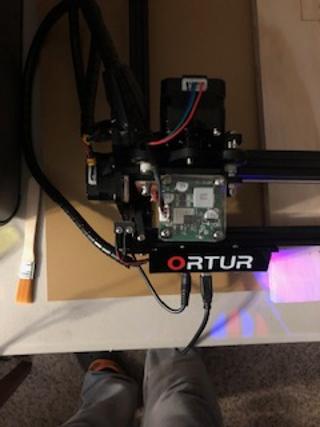

For you to be getting an alarm 2 when yous start a job this means the machine thinks its going out of “bounds” So outside the frame
This can ocour within 2 problems
a) your machine isnt homing correctly
b) while setting up Lightburn you selected x-carve/Shapeoko
So if you can so i can help
1_ could you move the laser head to the center of the machine. Power off, then record a 20sec video of the machine homing - as you power it On please?
2- in your console in lightburn when connected: Toggle the show all button. Then type $# in the console please. Show me the output?

Also when you have the head at Home position. could you tahe a picture from above at the Y limit switch being tirggered by the gantry?
home switch pic
If the vidio didnt come through it was same as last time moved from center to back left instead of front left
