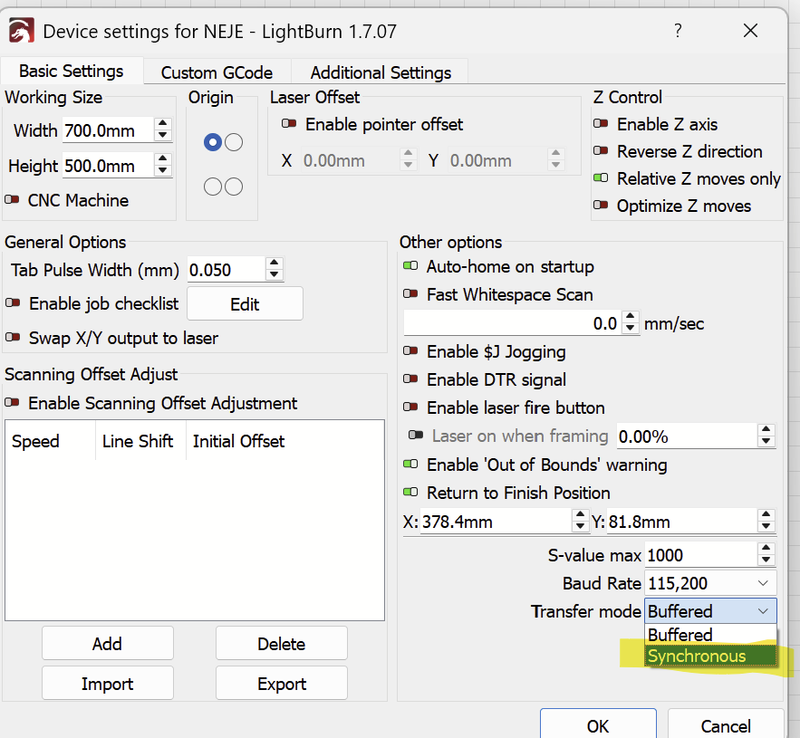

Hello Jim,
In the Device Settings window, try changing Transfer Mode to Synchronous.
Also, make sure, no other application is using the COM port.
From your Support Data, I can see, you added two devices in LightBurn. Did you select the correct one?
