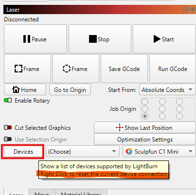

Did you close Atomstack Studio before opening LightBurn?
And selected the same COM port in LB?
Let’s try a right click on the Devices button in the “Laser” window to reset the current connection:

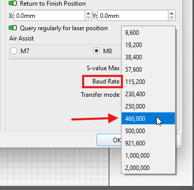

@michelwillaime actually, a Baud Rate mismatch is more likely to be the cause!
What’s your current Baud Rate?
Change it to 460,800 in the Device Settings:
