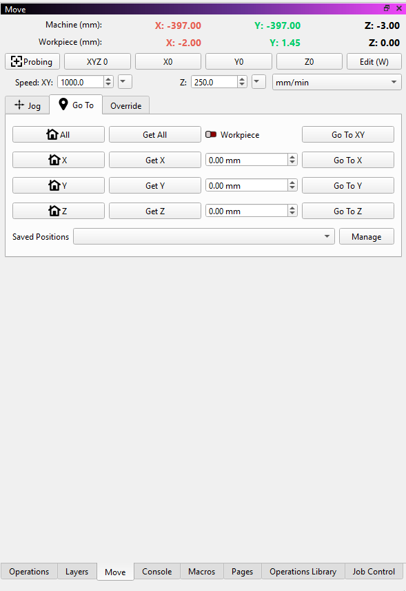

Continuous Jog in Move Panel only moves in one direction for X and Y
IF I set continuous jog in the move panel the system will only move in a positive direction on both X and Y Axis. Turn off continuous a Jog works as designed.

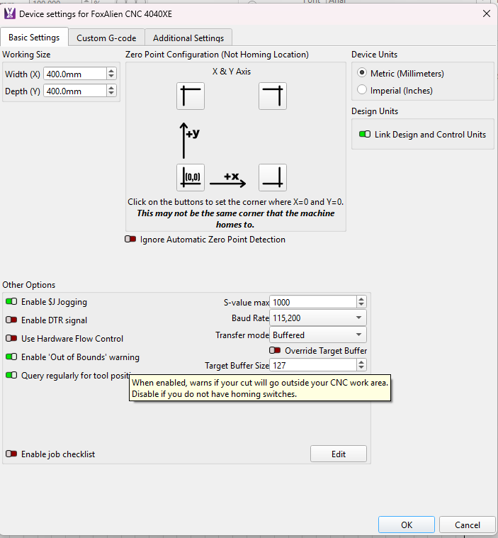

It’s almost always a device-origin/config mismatch, not a bug

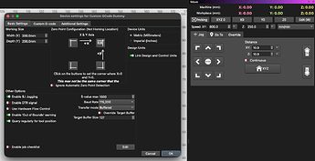

Which Foxalien are you using, and did you select one of the presets in MillMage when you added the machine?
Please send us a screenshot, showing your Device Settings and the machine’s position after homing, similar to this:
IF I set continuous jog in the move panel the system will only move in a positive direction on both X and Y Axis. Turn off continuous a Jog works as designed. Millmage Core 0.9.00 09/08/26
Do you have a G54 offset? I think those -397.00 machine positions are your problem.

You have your zero point set to the front left, but I’m pretty sure for that machine it’s rear-right. Try changing that.
