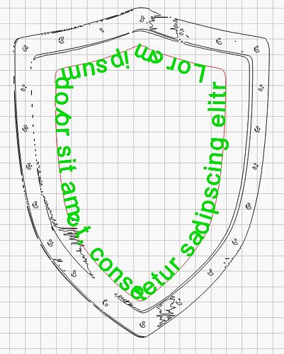

If you want to align text to a logo (in this case, a coat of arms), you can use “offset shapes” → outside only → to generate a line to which you can align the text.
I’m not sure if that was your question, but here’s an example:
Text_An_Logo_ausrichten..lbrn2 (212,7 KB)
