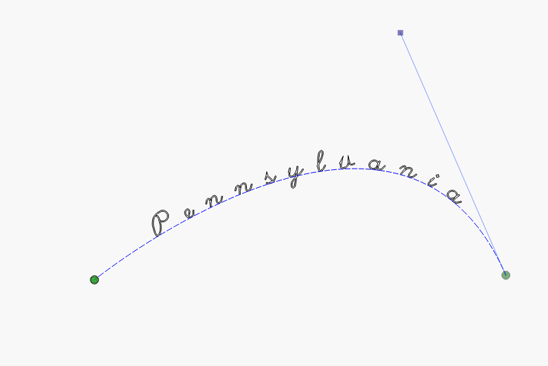

Copy on Path Directions Are not Providing Expected Result
Got it! Thanks!!!
Semi-educated guess…
Once the text is applied, the two are something like grouped. The text is no longer alone, so Vspace and Hspace can no longer act on it because they cannot isolate the text characters.
This stuff is so cool, no?
Only 2 nodes are enough.
But you get more when you go clickety-click with the mouse. :rofl:
2 nodes only:

I know. Sometimes I get a straight line, and sometimes I get a Bezier curve. My hand has not figured how to control the difference yet.
Just set the node to smooth and adjust.
Thanks…I learned something!
Thanks for bringing this up. I poked around to see what was happening. When you first use Apply Path to Text, both the path and the text are selected by default. If you either click off of the combined shapes or press the escape key, you can then select just the text and use HSpace and the other text options as you’d expect.
