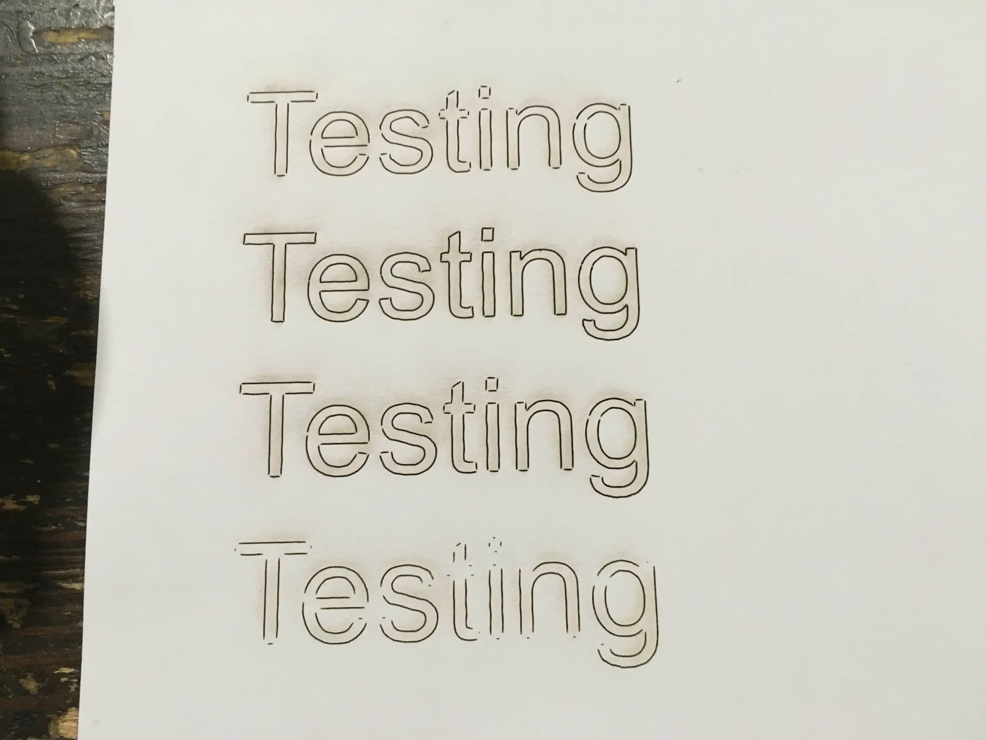

Using a Just Add Sharks SilverTail A0 laser cutter converted to a smoothieboard a few years ago, and with a 130W laser these days.
I’ve noticed that when doing etching, so high speeds and low power, bits of the lines drop out.
The picture shows four cuts made with exactly the same source and just the power and/or speed settings changed on each cut. I just moved the laser up by 30mm each time, changed the cut settings, and hit play
The material is 200gsm card
So the bottom cut is with 20% power at 100mm/s, the problem is clearly visible
The second from the bottom I increased the power to 30% and left the speed at 100mm/s, as you can see the problem is much reduced, but the very corners are still not being cut
Then the next one up, power was increased to 40%, this seems to have complete cuts.
So the more power, the smaller the problem.
But then the top one the power is still 40%, but the speed has been increased to 150mm/s, and as you can see it looks very similar to the 30%:100mm/s cut
So it seems that both speed and power have an effect.
I’ve looked through the various parameters I can find in lightburn (cut settings, device settings), and also config options for smoothieware, and I don’t see anything that might be causing this. The old software we used to use before the smoothieboard conversion had a separate corner power cutting parameter, but lightburn does not have that as far as I can see (at least not with a smoothieboard).
Am I missing something in the lightburn or smoothieboard options? If not, does anyone have any suggestions as to what might be happening and what to do about it?

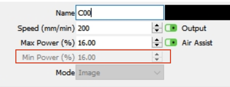

If you mean this min power, then I don’t have it (I grabbed this from an online image)
 ![min_power](https://forum.lightburnsoftware.com/uploads/default/original/3X/3/2/32f7de65546b13f4ac3175b354a70e125357a7f5.png)
It seems min power doesn’t work with gcode controllers?

To be clear, I don’t have min power in the cut settings for lines at least, it may be there for images (I am not in the same location as the cutter right now, so I cannot check)

Is the Smoothieware more like a GRBL controller than a Ruida? Min Power is available only in Greyscale inages in GRBL.

It does seem that the laser is being turned off at the corners though, which suggests some sort of incorrect scaling. But it’s a bit unclear to me what settings might affect this and where in LightBurn or the smoothie config to find them

Ok, GRBL with Constant Power **off** varies the power as the speed changes. This keeps from frying corners in the burn where the laser slows down. A diode laser can go as low as 0.2% and still fire.
A CO2 laser minimum power is in the 8%-10% range from what I have read. Below that and it just ceases to ignite. It sounds like you are dropping below that threashold in the corners.
The solution is to raise the minimum power setting. In Lightburh for GRBL, only Greyscale images have a Min Power option. However, GRBL parameter $31 can be set to 10 or 12 to give you the same control.

You’re likely running below the lowest power that will reliably fire that big tube. My 60 W tube doesn’t fire well below 10% and reports indicate 20% may be about as low as 100+ W tubes can handle.
A GRBL controller handles the power scaling internally, so it does not have the `Min Power` setting available with DSP / Ruida controllers. That means the controller _will_ reduce the power based on the actual (not programmed) speed, so corners and direction changes tend to get lower power … which, in this case, will cause the tube to stop firing.

Looks like these machines had a Ruida or dsp controller in them stock.. why would you put a grbl board in there?
Most of the grbl boards do not run the tube as an analog device, the run it like a digital device, much like a diode or rf excited laser. With these, to get 50% power, they run 100% power for 50% of the time. A tube can run 50% power continuously.
If the controller is slowing it down to go around the corner, then usually, that would create a burnt corner. You have the opposite issue.
I’d suggest you figure out what these wobbling line are from. This needs to get sorted out or all you’ll produce is scrap anyway.

OK, so if the problem is the scaling of power at the corners then smoothieware has a couple of settings that theoretically should affect that.
One is a config value named laser\_module\_minimum\_power, which is the minimum value the laser should be scaled to when turned on, so if it is set to 0.2, then a nominal laser power of 0% should in fact be 20%
Changing this makes no difference, but I have not found a way to check the config is being read correctly, so a little bit of a question mark on that one.
However the other option is to do M221 P1, which is supposed to turn off all scaling, and indeed when I send the command the message I get back is “Laser power scale at 100.00%” which seems to imply it is doing what I expect.
This also does not affect the corner dropouts.
Which is currently making it look like the problem is not what it looks like
