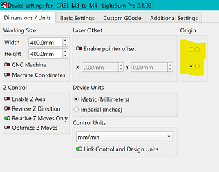

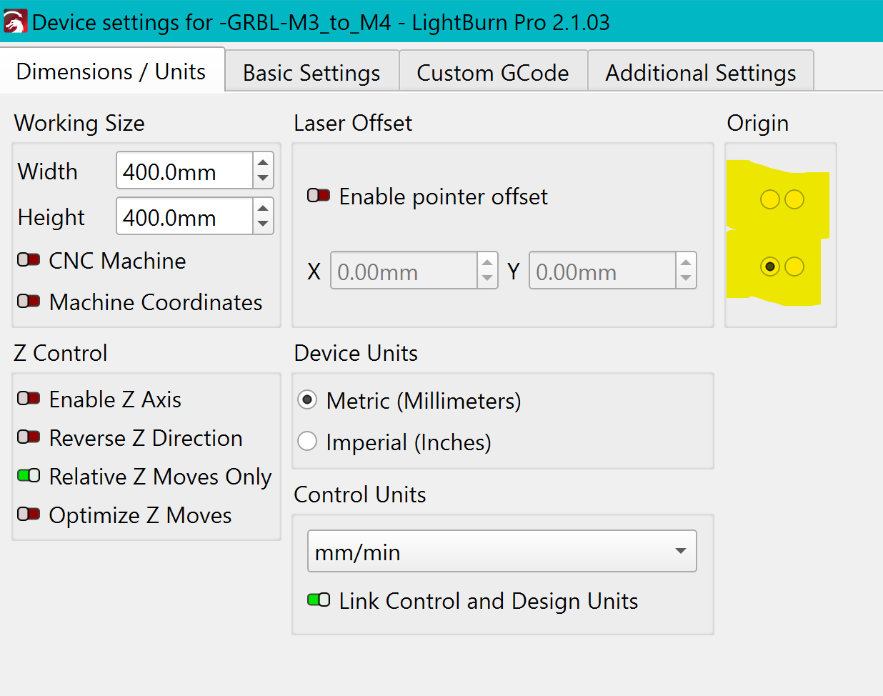

As a start check Device Origin:
On a Falcon, the Origin in the Device Settings should be set to bottom left, as shown in parsec’s screenshot.

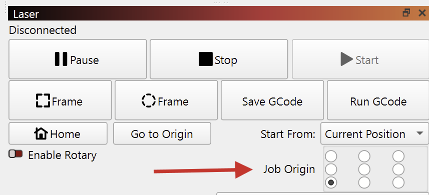

Were you referring to the “Job Origin” in the Laser window instead?
See if it works better with the “Start From” value set to Absolute Coords.
Does the laser move in the correct direction when using the jog buttons in the “Move” window?
