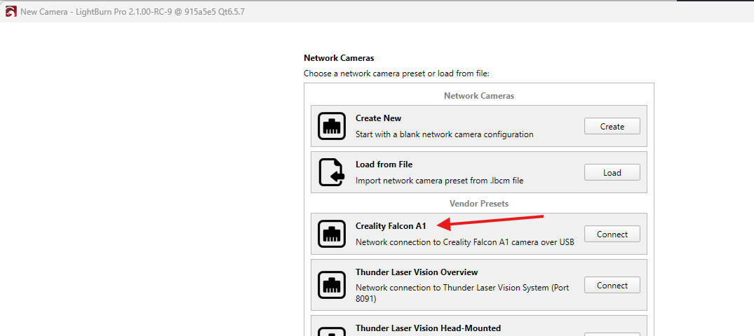

Good evening,
I just tried to get my Creality Falcon A1 Pro up and running with LightBurn RC 2.1. The printer is detected thanks to the profile, but unfortunately I can’t get the camera to work. Is there a trick to this?

> [@SirJuergen](#):
Did you add the camera? Or can you explain in detail what doesn’t work?
Although the camera is connected over USB, it uses the [RNDIS protocol](https://en.wikipedia.org/wiki/RNDIS) and is therefore only supported in the upcoming version 2.1, and the RC.
To add it:
Go to “Laser Tools \> Manage Cameras”
“Add New”, select Network, and choose the vendor preset for the Creality Falcon A1:
 ![image](https://forum.lightburnsoftware.com/uploads/default/original/3X/0/f/0fdbd2a5ceaf3f52bd1f604c9e9465c5d902a289.png)

Good morning Aaron,
thx a lot for the hint ! This solves my issue. Indeed I was on the “USB-Track” because the equipment is connected via USB but in that way it works pretty well 😉

Thank you for the feedback!
I figured that this was the reason why you couldn’t find the camera and already made a request to move the Vendor Presets to the first step of the wizard. While it’s technically correct that RNDIS is a network protocol, I get that someone would look for the camera under the USB option.
