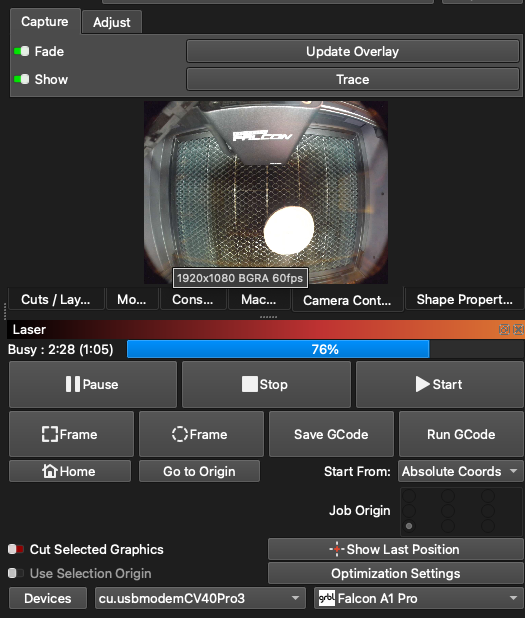

So, I got it working just writing a guide now, its a pain but if your desperate for the camera it does work!

I’m here I’m here, so I downloaded and installed OBS studio, set up a browser element linked to the camera IP, then turned on Virtual webcam this requires OBS to be manually refreshed to update image, so I wrote a html page to auto refresh every 5 seconds, then plugged that into OBS

Okay, _very_ hacky! 🙂
If it works, it’s not stupid. Brilliant, in fact!
Don’t be too confident that this will still work from version 2.1 onwards. (also, it shouldn’t be needed anymore)
The camera system has been/is being comprehensively revised, and unpredictable layers significantly interfere with lens calibration and camera alignment.
