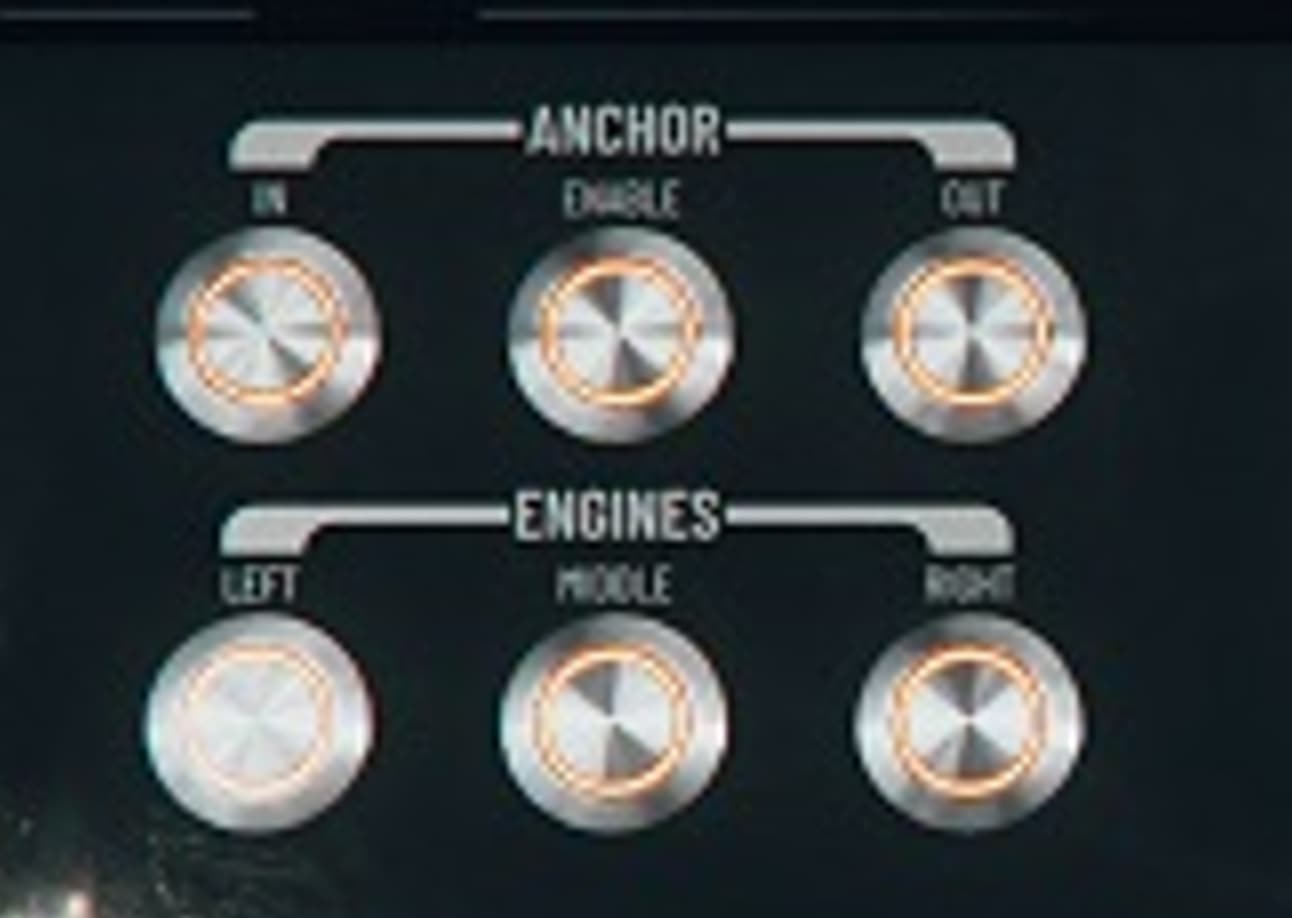

How can i recreate these “accent lines” around the switch labels using the draw lines tool? My efforts are abysmall and nothing is coming out symetrical and can’t seem to match the same thickness of the lines. TIA
I used the line tool on one, followed the straight portion, clicked where the curve started, clicked where the curve stopped,clicked the bottom corners and went back to the start. Then, I created the curves and adjusted the lines using the node tool. When I got it close enough on one, I duplicated that one and moved it down. Then I duplicated both, flipped horizintal and moved over the other side. This might be close enough for you. You can play with the nodes if you want to improve the trace
