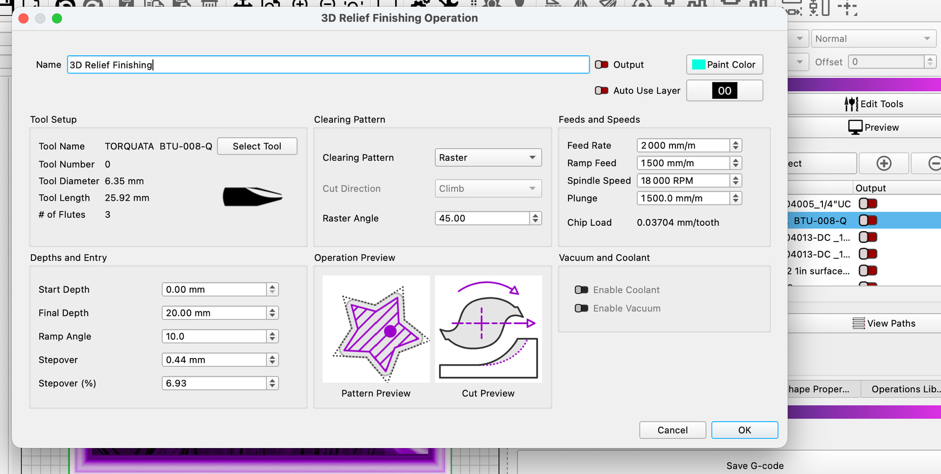

Hey there folks,

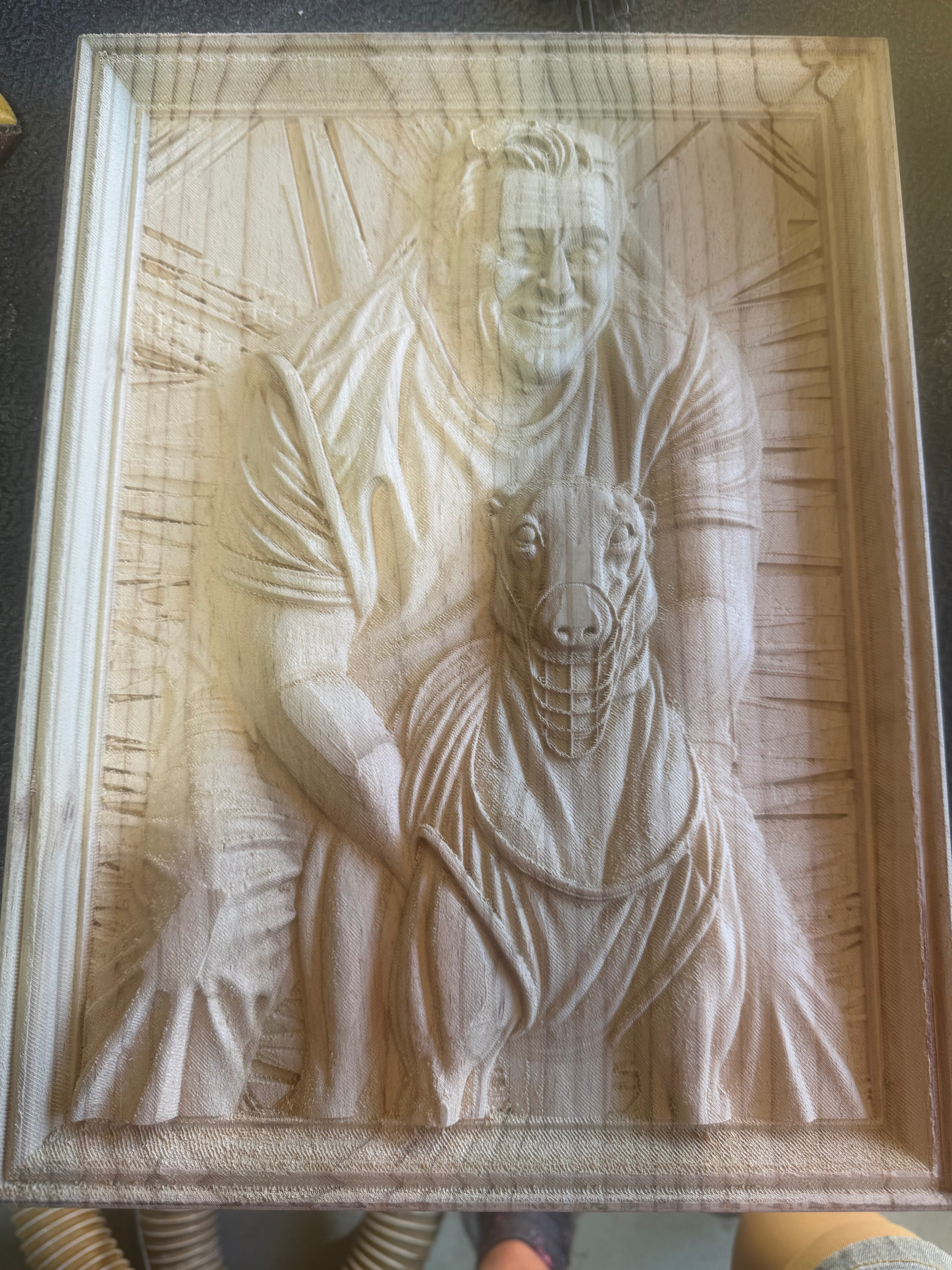

My name is Pat and I have a Genmitsu 6050 XL Plus at the moment. I’m still making mistakes, learning as I go, and actually enjoying the problem-solving side of things!
I decided to try my hand at a picture that Yohan converted to an STL file for me — I think! :grinning_face_with_smiling_eyes: Anyway, I did the carving and only used cheap pine as this was really a test.
But here’s why I’m asking for some advice from people who do this sort of relief carving regularly. It takes bloody hours to confirm you’ve stuffed it! HEHE.

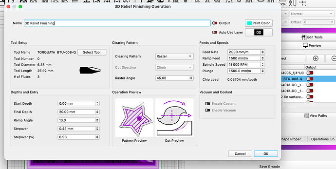

I’m using a Torquata 0.8 mm diameter tapered ball nose (TBN) bit. For the finishing operation I used a 0.384 mm stepover, all done in MillMage Pro.
I’m going to try to add a couple of photos along with the finishing-operation settings.

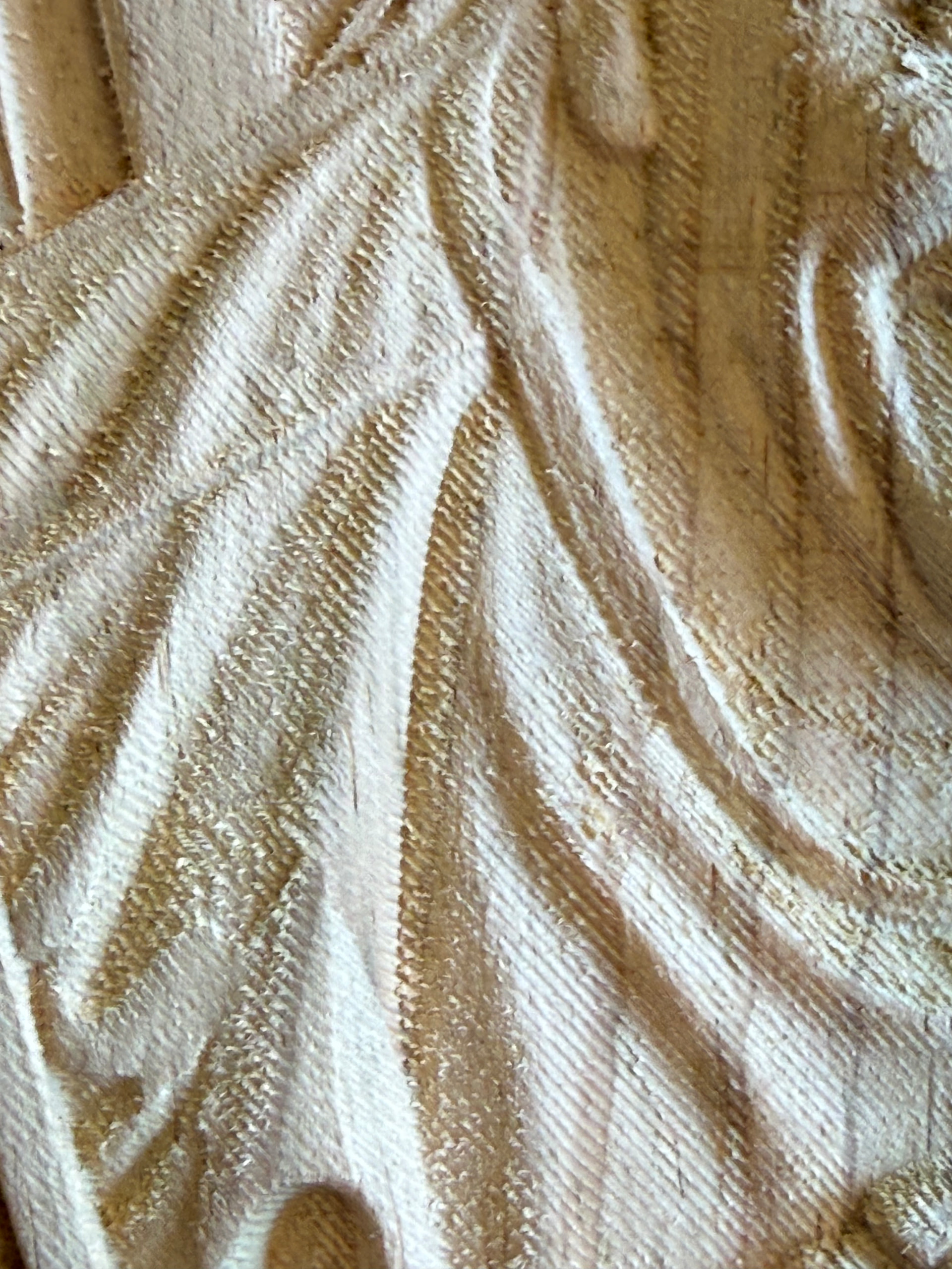

There are a LOT of visible lines in the finished carving. I thought my stepover would have been adequate, but looking at the result, maybe not?
I’m in Australia, so obviously we have different timbers available, but cheap and nasty pine is probably cheap and nasty pine worldwide! I understand it isn’t the ideal timber for this sort of work.

1. Is the pine likely to be a major part of my problem?
2. Would you suggest reducing the stepover considerably from 0.384 mm?
3. I’m running the finishing pass at 45°. Would that make much difference to the final result?
4. One suggestion was to run another finishing pass in the opposite direction (-45°), basically creating a cross-hatch pattern to clean it up.
That sounds reasonable, but it takes the machining time from around 6 hours to 11 hours. That’s a long time to wait just to discover it still isn’t right!
5. Is there a way in MillMage to isolate a small section of a relief for testing?
I tried using a mask so I could machine just a small test area, but it doesn’t appear to work with reliefs — unless I’m doing something wrong.
I don’t really want to simply shrink the entire relief because that isn’t the same test.

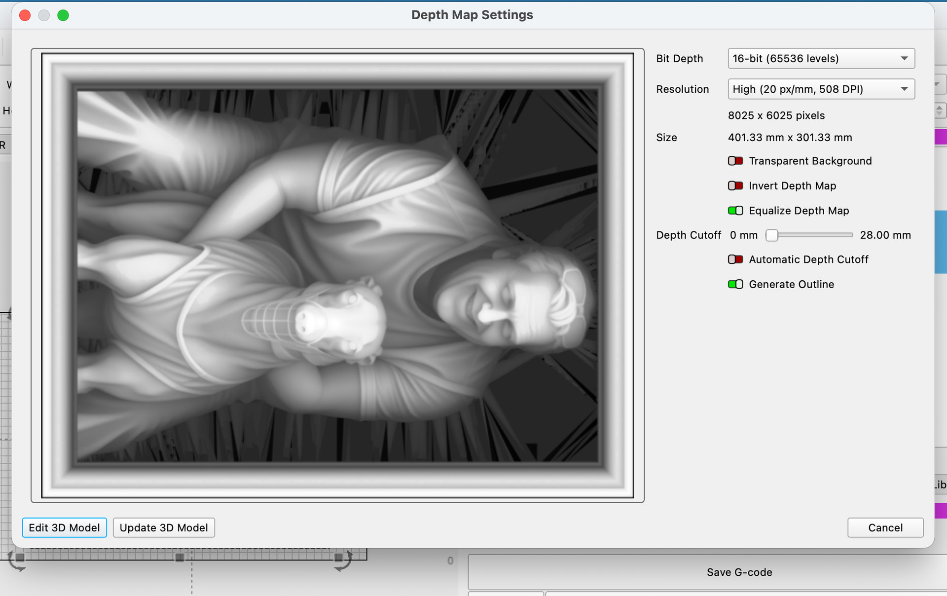

For this particular job I also used the option that changes the background so the subject stands out more. I’ll experiment with that setting as well.

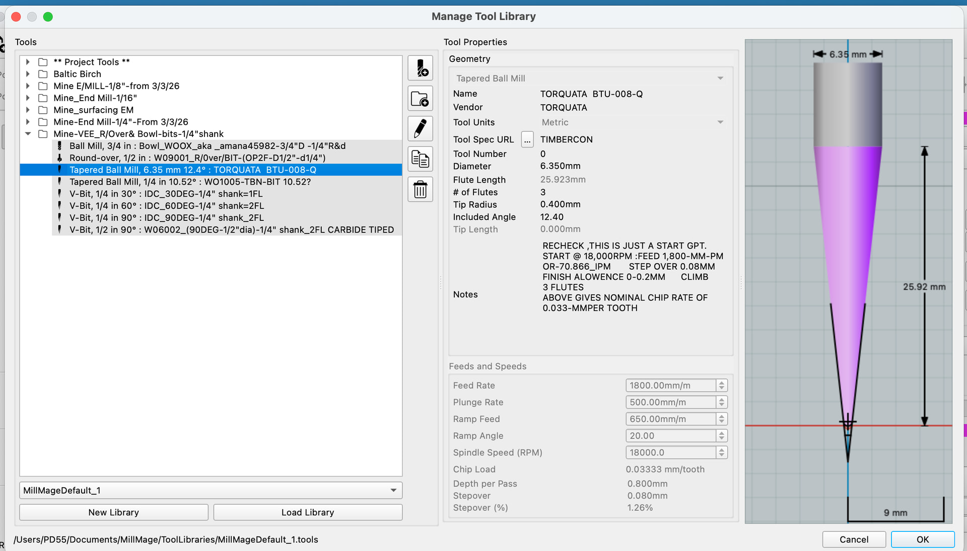

in your bit notes, it says to use a .08mm stepover. But you are using a .44mm stepover

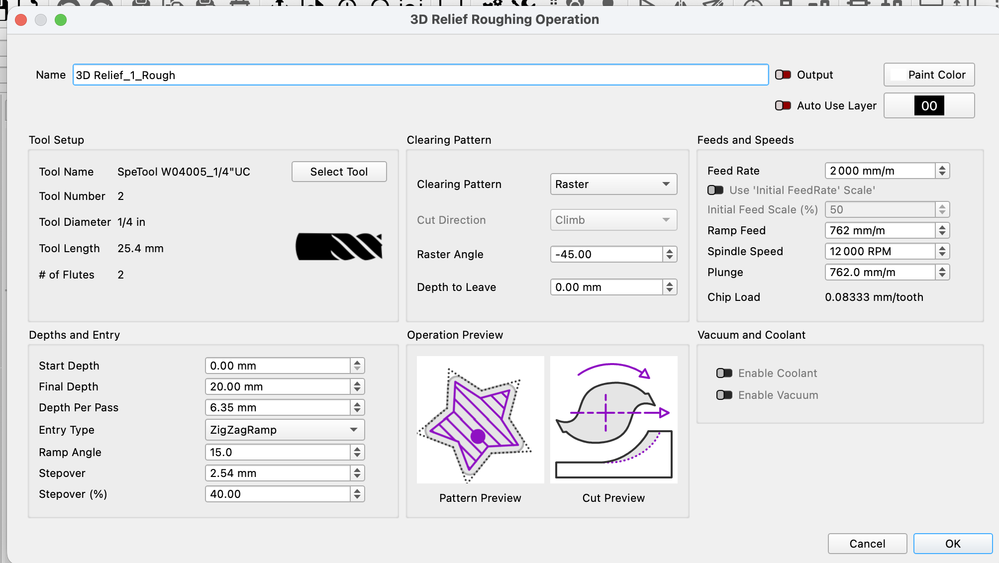

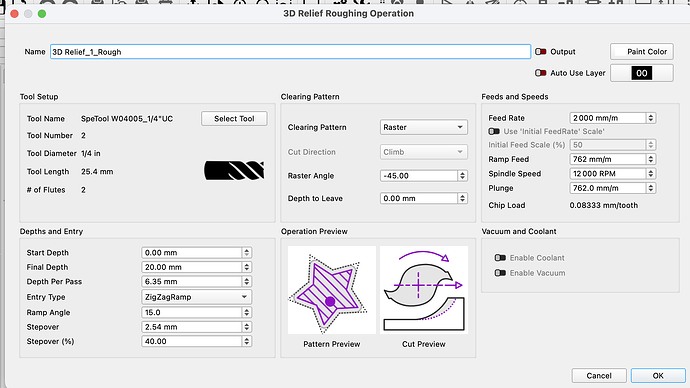

Unrelated to the topic you are asking about. I would be interested in seeing your roughing bit settings.
It appears you are using a 48% stepover. I think something like 12% or less is recommended.

pine is to soft so u will get those marks redwood does the same , i use nz totara soft but dense
, get urself some of the red scourer pads its about 320 grit , and rub it most will disappear, the other trick little brass wire brush in a dermal gets rid of the bits ur fingers wont go
i run on angle with softwood dosent seem to rip it as much
from my experience only way to minimize lines is slow right down , if u stand back 2-3 feet u cant see the lines

thanks Jack here’s a pick of what I used was a 1/4"UC
I was useing 5.94% step over .Mikey
that’s , as I see it around 5-6% from memory was something like 5.94 ??? I put 6 in and it changed to this no so say 6 % of a diameter tip of 0.8 ??? don’t know where your getting 48% from mate???
I did not say anything about 48%. I did say .44mm if that is what you are talking about. But that is what your settings page says

Now that I have looked at this again, it takes me a bit to study this as I still use imperial units. But first the bit. That is a very small bit. So a carve is going to take way too long. For anything over a 5 inch carve, I use the IDC Fine bit.

That will take a 10 hour carve and turn it into a 3 hour carve. A smaller bit will give you mare detail but you will reach a point of diminishing return. Where the model does not have enough resolution to take advantage of the smaller bits. Just takes longer for no reason. Cuz all the extra passes that the bit travels. And Pine is not the best to carve in. That is where all the fuzzy is coming from. But that is not where the lines are coming from.
The reason I wanted to see the roughing pass settings is I think I spot some flats in your carve. around the knee and the dogs nose and the mans arm. I am seeing them in some of mine if I don’t run the roughing at full depth. If I set my roughing pass to .25 or .125 inch per pass, I get flat spots. If I run the roughing at the full final depth, the carve has no flats.This should not be happening.
I was using this with the 0.44mm stepover. Your stepover is nearly half the ball diameter.
Are you thinking Tool Diameter is the same as the Tip Diameter?

To do a smaller test region, just draw a shape around the area you want to run and add it to the operation. 3D Relief and Roughing operations allow you to add shapes that define the boundary of the operation.
