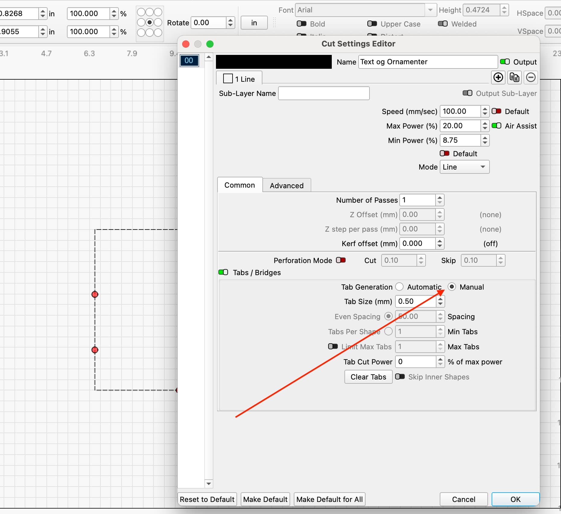

Creating tags to stop parts from falling out
I did get tags to work, but now when i clicka new one the others disappear.
In the “Cut Settings Editor” you need to set your tabs to “Manual”
Many thanks for that - it worked a treat. Lightburn is not the easiest program to learn, but I’m getting there…
