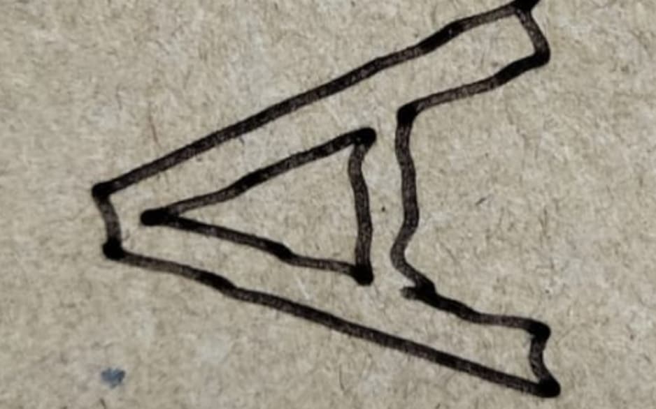

Crooked line when cut, fine when fully filled. How to fix it?

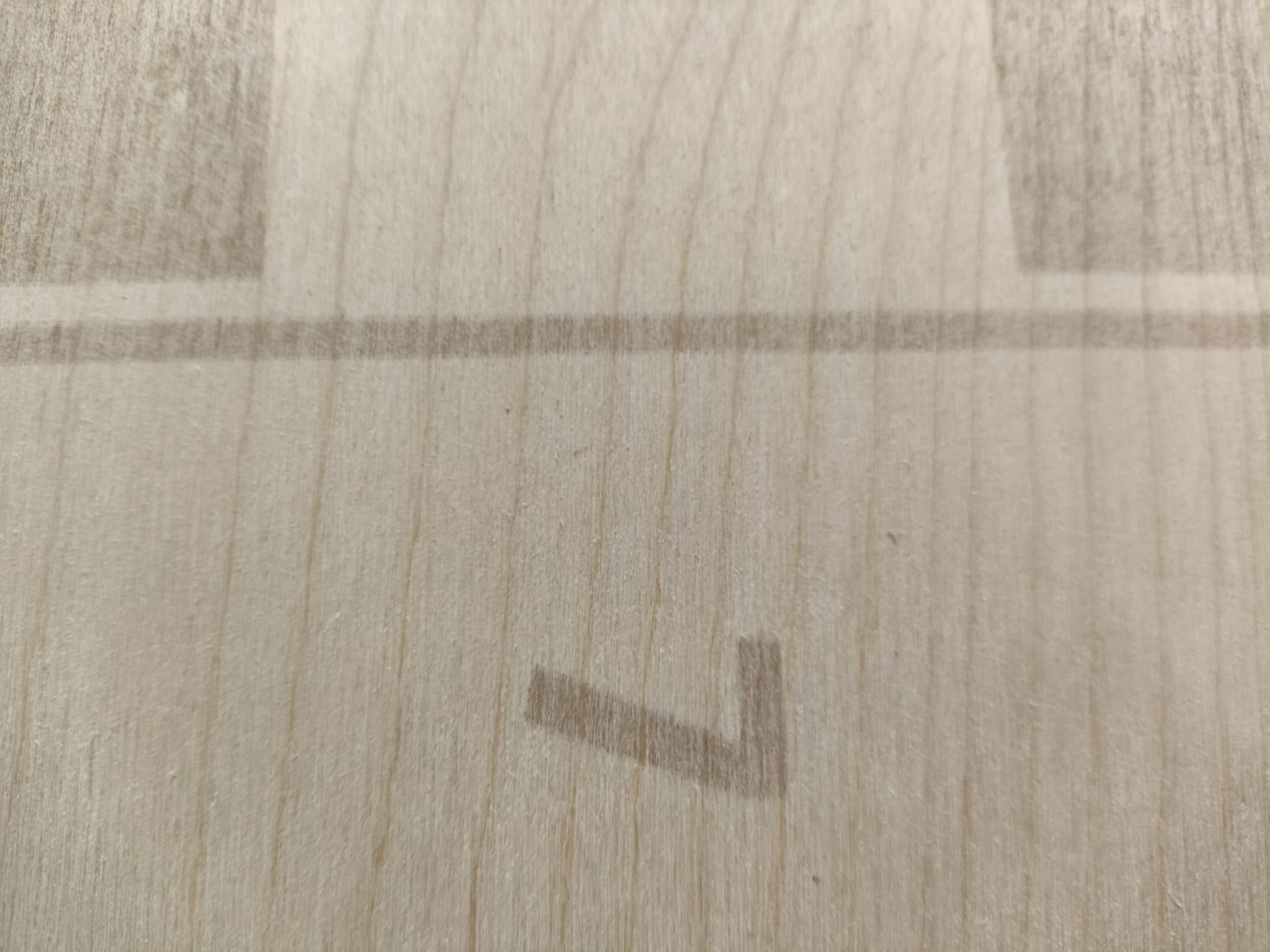

If your machine has mechanical problems (and it does), then the result is the same in fill mode, you just don’t see it as clearly.
It’s not a mechanical problem, I have something wrong somewhere in the settings.
Fill comes out perfectly. Before changing the computer it was engraving correctly.

If it’s something with your settings, then it must be a big one.
I think one axis is not working properly. Maybe you are right and it is the mechanics.
I wonder what I broke :slight_smile:
You haven’t ruined anything :wink: but sometimes the timing belt becomes too loose - or they are too tight. Another, slightly more iritrating problem could be that one of the small pinol screws has loosened in the pulleys.
I checked the mechanics, it looks ok. Any other ideas?
…but it’s not, believe me :wink:
If it was a CO2 machine it could also be a loose lens in the nozzle, but you have a diode laser…
Although Sculpfun mentioned, this applies to nearly all gantry lasers.

The lines absolutely are mechanical, there is no software setting that will make that happen, unless you are simply trying to push too fast. That does not look like it is simply too fast.
The corner overshoot may indicate excessive speed
The rest is mechanical slop
