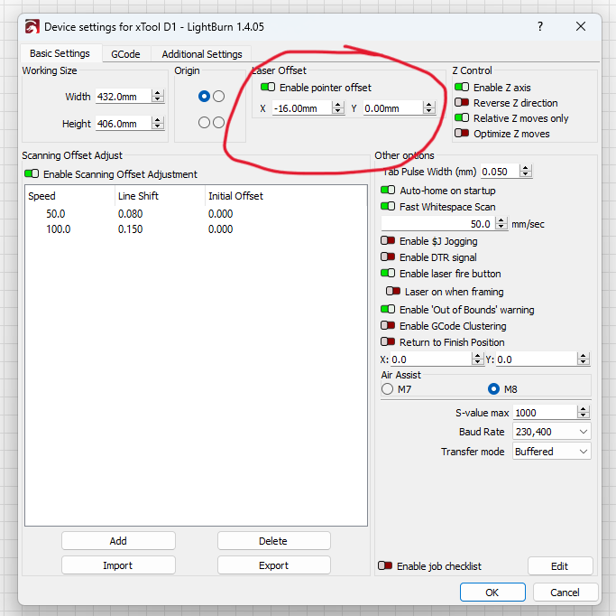

My crosshair is off and I can not get it to adjust when I change the settings. Makes no differents what numbers I put in, its alway off by the same amount after I check for adjustment.

I test by burning a point then send the laser Home. Then I use the laser positioning button to move the laser back to the center of the point I burned.
When offset is disabled, it does not allow you to input adjustment values.
If I’m reading this correctly this may be a misperception of how pointer offset is supposed to work:
  1. the crosshair should be used to position the design on your material or otherwise indicate where design will be burned onto the material
  2. when the job is run, LightBurn will offset the motion such that the primary laser is now positioned where the crosshair originally was

I know how to move the crosshair but the adjustment does not respond. its about an inch off center. Changing the offset values does not change anything.
The offset adjustment is not doing anything.

Thank you. I have it working and aligned properly now.
That’s good. What changed?
FYI - It was my stupid move. I knew better but it had been so long since I had worked on the offset. I was trying to move the crosshair to the burn instead of moving the burn to the crosshairs. Dumb move. I’m embarrassed. Thanks anyway.
