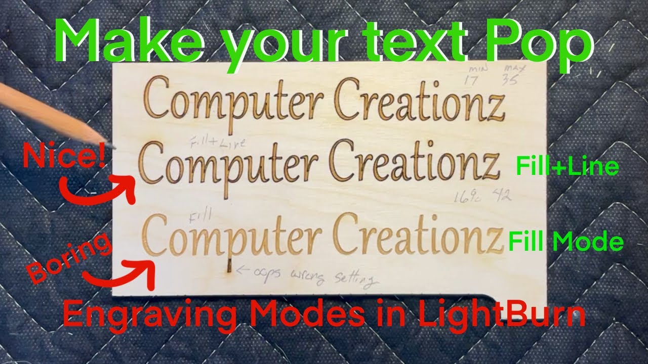

This overview is quite good.
[![](https://img.youtube.com/vi/TD2vZ5hoW6M/maxresdefault.jpg "Want better engravings with your laser? Use Fill + Line in LightBurn") ](https://www.youtube.com/watch?v=TD2vZ5hoW6M)

Thanks John for the video. This aligns with what I have been doing on my 2D work, without doing anything with the min power setting.
I still think there is something I am missing as to why this is doing this while on the rotary.
I will do a test with lower power for the line, but based on what I am seeing the feed is still slower on these curves based on the rotary speed and will still be darker than straight lines, but maybe less noticeable.
