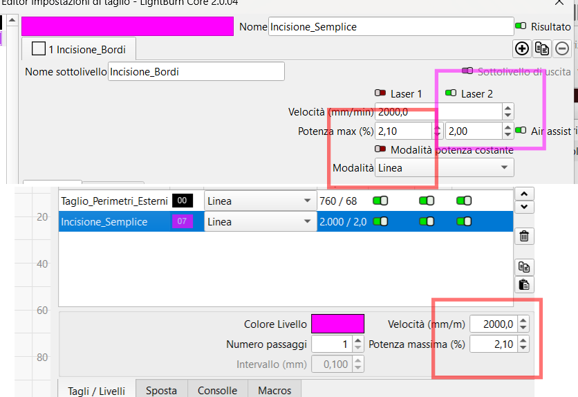

Good morning,
I recently started using the custom Gcode version of Lightburn.
I’ve encountered some problems…
I wanted to bring this issue to your attention:

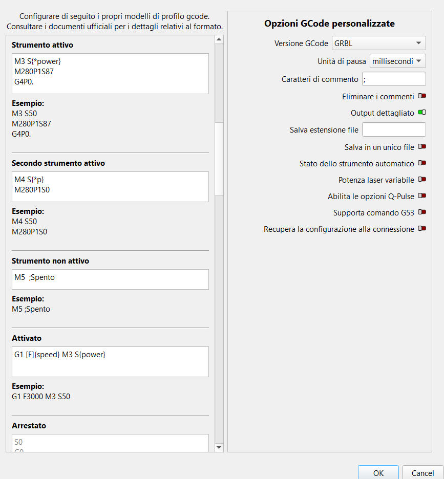

I set the activation of tool 1 with the M3 S{*power} command.
The activation of the second tool with the M4 S{*power} command.
The problem is that power points to the power set on the first tool!!
Is it possible to have a command that points to the power set on tool two? For example:
M4 S{*power2}!
Is it already possible to do this? I haven’t found any documentation on this…
Thanks in advance for your support.
Regards

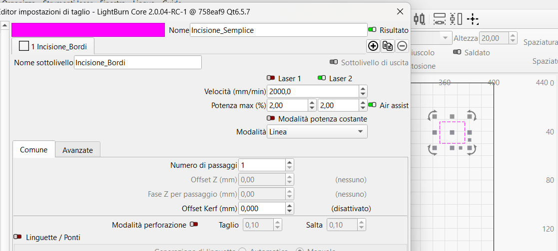

Maybe it’s my fault; I still don’t fully understand how everything works, but I think there are some anomalies and differences in the code generation compared to the “normal” version. This morning, if I generated two simple squares, one with tool 1 and the other with tool 2, the power S wasn’t set for the second one… so I added M4 S{*power}. And I noticed that S{*power} was pointing to the power set for tool 1.
Now I may have solved it, but I’m still unsure!

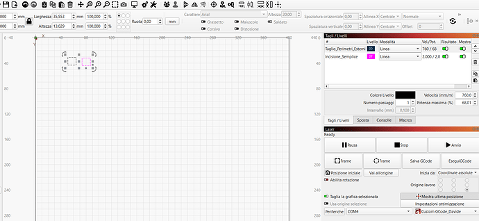

They are two simple squares, the first with tool 1 (cutting), the second with tool 2 (engraving only).
As you’ll see (following your advice), I added a servo control that closes the valve that regulates the air flow. The M8 control turns on the air compressor.
Now it seems to work even without setting S{*power} for the second tool!
Do you have any suggestions? Did I set something wrong?

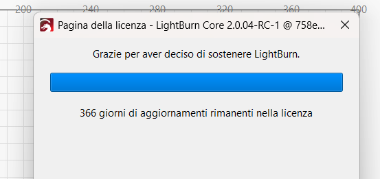

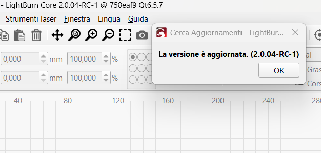

You are using an older Pre Release version, but 2.0.04 has officially launched.
Please see if the latest full release behaves differently:
(In case your license key expired for free updates, you can temporarily deactivate it under “Help > License Management” and reactivate the free trial.)

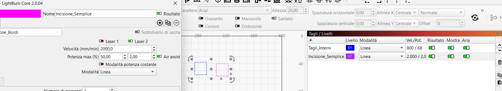

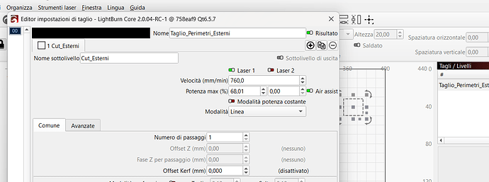

Just ignore that second ‘Max Power(%)’ edit box and only use the first one. (I don’t think it is supposed to be showing).
And you shouldn’t need to include the “Sxxxxx” after the M3 or M4 for “Tool On”, since the power value only needs to be used in the ‘Cut Move’ area.

Hi,

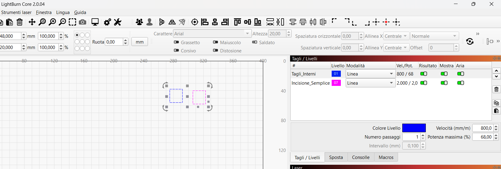

I also downloaded the latest version…

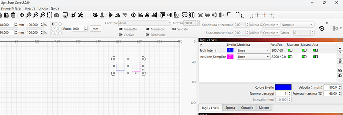

Here’s the problem I was telling you about!!
As you can see, two simple squares: the first for cutting, the second for engraving only! It seems to be pointing to the power set on tool 1!!

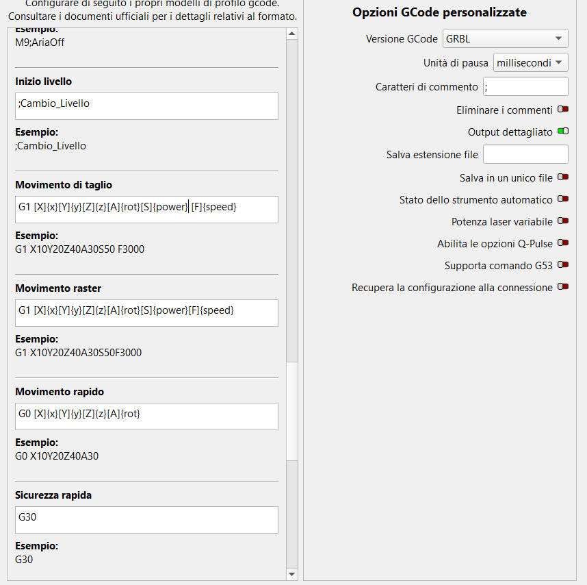

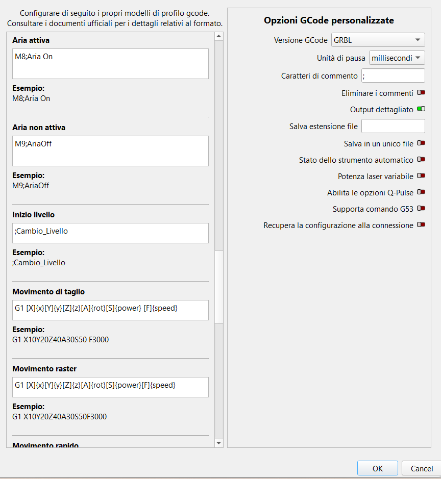

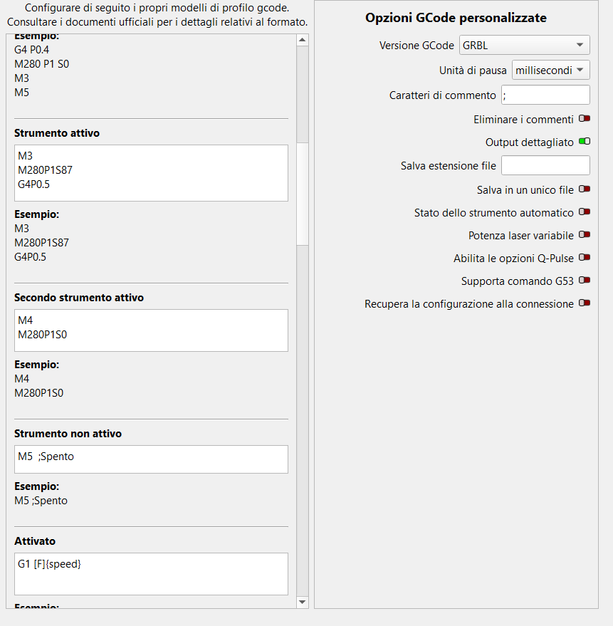

As you can see here:
M280P1S0
G1 X158.5S500 F2000
At the moment I can solve it by putting the same power on both boxes (P1 & P2)… But I think there is a problem to solve!
These are the current settings!
Am I doing something wrong?
I wanted to show you this too…as you can see from the pictures, I made a red box and you can clearly see that it points to the tool 1 power! I hadn’t noticed before!
