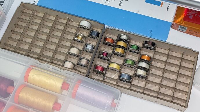

Customized drawer organizers are handy:
I made those with TroCraft Eco, which is sort of an upscale chipboard, held together with PVA wood glue.
