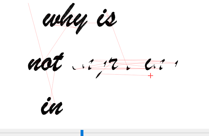

Courvy font cut jumps arround a lot. It’s worse when it’s framed. Any optimization settings i tweak don’t change nothing at all. Am I doing something wrong?
This is framed courvy (brush script) mid work
It’s all over the place
This is unframed courvy:
It jumps arround within a word

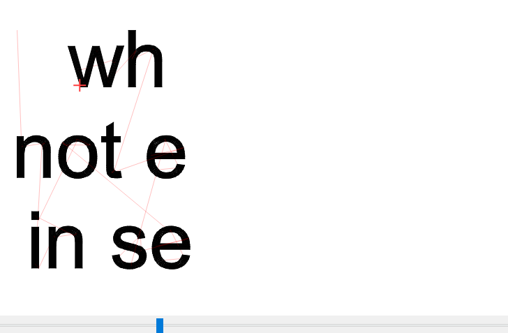

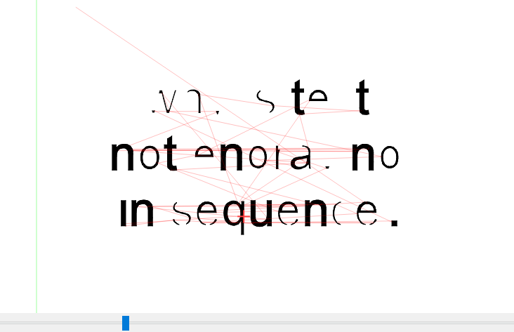

This is unframed Arial and it does what I expect
Framed Arial again jumps all over.
What does the frame have to do with it if it gets etched last in anyway?

The issue is that you’re using offset fill. Suggest you use standard fill. If you want to use offset fill for the frame then put that on a different layer.

Sure, but what about this. No frame, brush font and the path jumps arround?

I guess it’s because letters are connected. Still looks like far from optimal to me.

You’re still using offset fill where this type of motion would be expected.

As opposed to what? What I was saying is why does it not finish the letter it started. The courves closest to each other. It goes to beggining of the word then middle then end then back to beggining of the same word and several times like that.

Mandor:
As opposed to what?
Standard fill.
Optimal path for offset fill may not be obvious and frankly has limited utility in laser operations and will almost always result in worse quality.
Is there a reason why you’re focused on using it?
