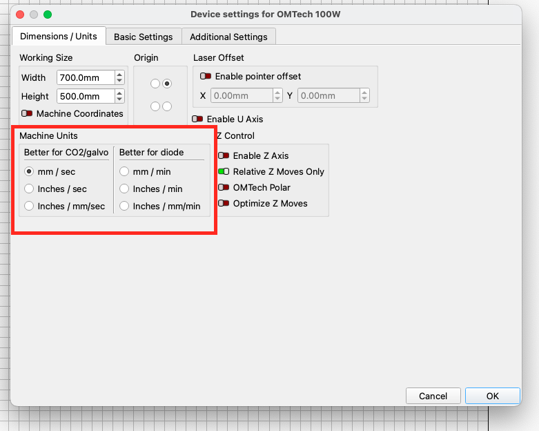

I’ve noticed that if I start lightburn after leaving it on in it will not change the cut editor settings back to mm when the main bar toggle is used. Even in the machines settings pop-up the setting is mm, but in is still displayed for Z Offset and Z tep per pass. The only solution I have found is usually to leave it on mm and restart the software. Anyone else notice this?
BUMP problem exists in both cut settings and move window. Changing units in settings to mm has no effect and units remain in Inches for those two settings windows. Anyone have advice on how to get everything back to metric?
You have to make the change to machine unts in device settings. Changing the screen units does not change the speed anymoore, since version 2.0.
Thank you for the reply. I’m not sure why this changed itself to Inches / mm/sec. I did not think to check since I have never changed the setting after initial install of the laser 5 years ago.
