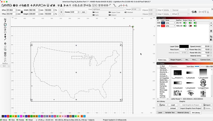

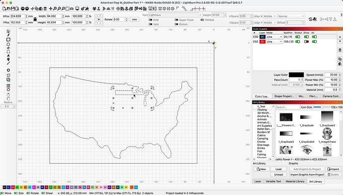

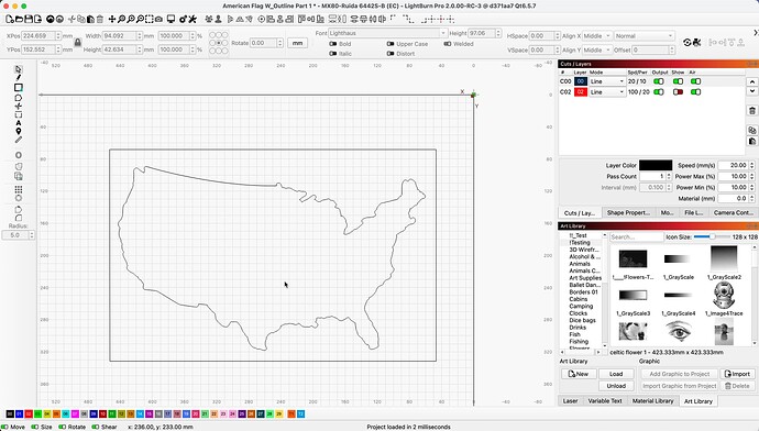

Does anyone know how i can easily cut out just the outline of the flag in this design. Its made up of multiple sections that are part of the internal design elements
American Flag W_Outline Part 1.lbrn2 (101.0 KB)

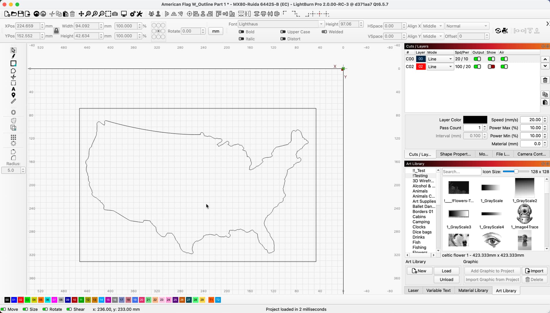

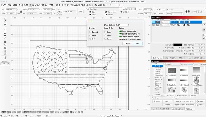

Obviously many ways but what I would do is select everything, then offset outward but a small amount (ie .01"), select the offset and move to a new layer. Hide the original layer. Clean up the offset by deleting everything but the profile (ungroup first). Then offset the profile back inward the same small amount.
Done.

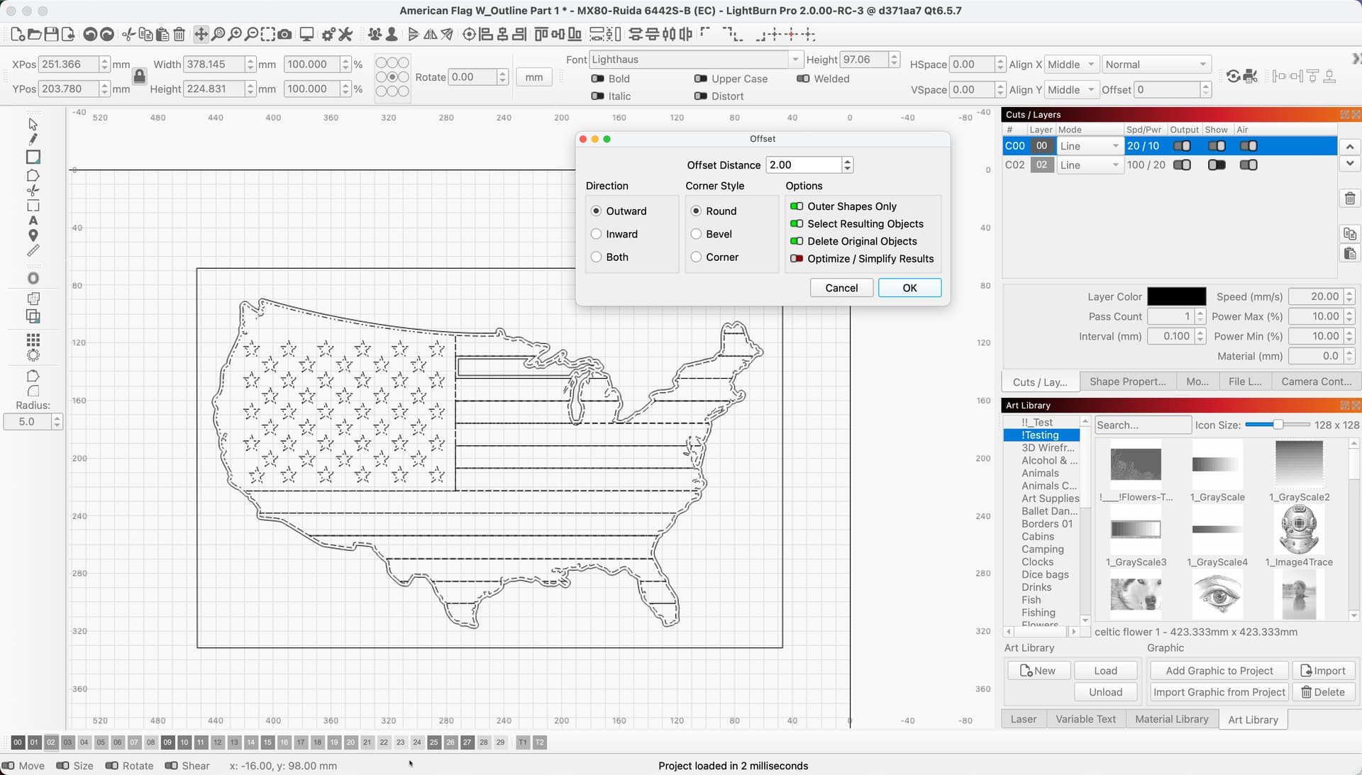

I duplicated the original flag components and put on a different layer to save original art. Then select all components of flag and use ‘Offset’ as @Demus identifies. I set the Offset to use the ‘Outer Shapes Only’ to produce the outline, selecting the ‘Delete Original Objects’ then delete the undesired elements.
Thanks Guys. I’ll give this a try.
Please let us know how you progress.
That was a big help from everyone. Used your instructions to get the Offset created, then a little cleanup and it came out perfect. Just have to finish the cut layers.

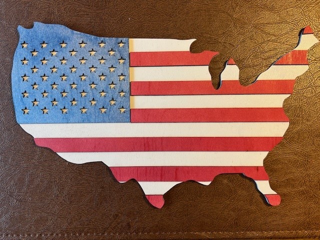

I’m looking to create something similar to the one below that I did. But this one is a little more complicated. I appreciate all your help. I can usually figure things out on my own but this one is a bit of a challenge.
American Flag.lbrn2 (301.1 KB)

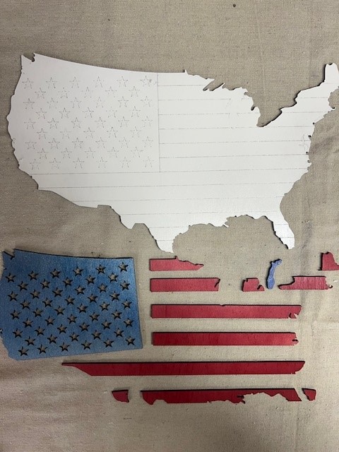

I’m trying to duplicate this one i did on my CNC. Its a bugger to paint so I figured if I could do the design and laser cut it, I could paint and assemble instead of working one one piece

Final design. A few small issues but for the most part I’m happy with it. Again, thanks for everyones help.
I’ll send a picture when its done:
American Flag W_Outline Final Part 1.lbrn2 (378.6 KB)
American Flag W_Outline Final Part 2.lbrn2 (383.2 KB)
Paint the backing plate white
Paint the cut outs Red
Paint the Stars Metalic Blue
Paint the lake piece Blue
Glue everything on

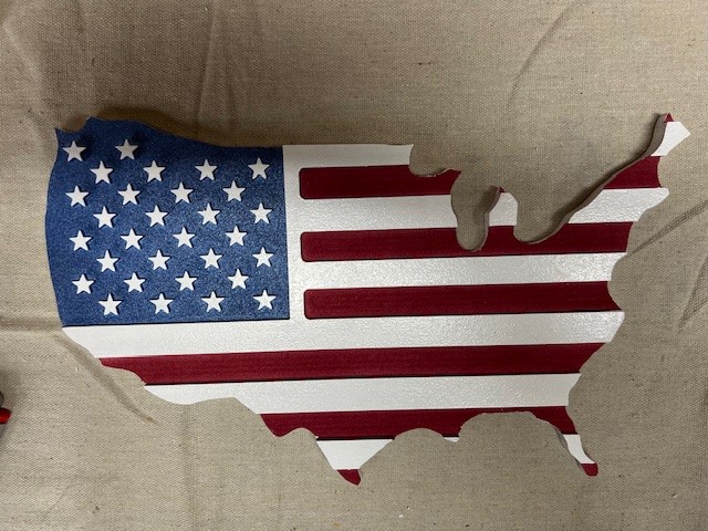

Made a few changes to my original version.
USA outline was too busy. Smoothed it out a bit
Final Version. I’m very happy with the way this one turned out
