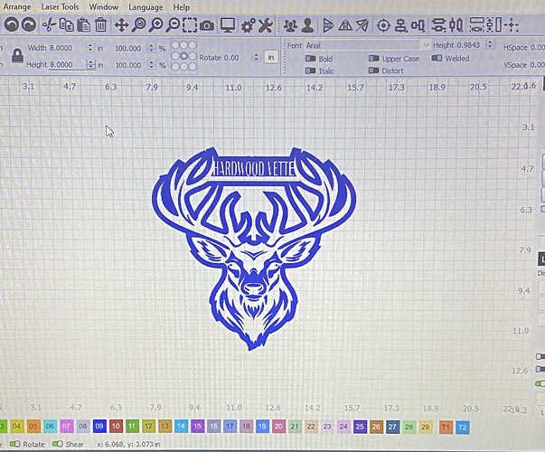

I’ve been trying to cut a project larger than my laser bed (16x24) for 1 month now. I printed and followed the step by step instructions that I found in Lightburn forum from July 2023 as well as watched the Mermaid video numerous times with no luck. A customer is requesting a 20 x 20 Antler cut out. I engraved & cut out an 8 x 8 Antler which is attached along with the svg file. However, when trying to engrave & cut larger than my 16x24 laser bed is where I’m having difficulties.

I like the photo of the completed engraving.
Thank you! The completed engraving/cut out is a 8 x 8. I’m needing to engrave & cut larger than my laser bed for a customer. Still trying to figure out how to do so.
I think you lost me…
If the engraving is only 8x8, why can’t you do that in your machine?
Even if the material is 20x20, you can pick where that 8x8 engrave area is located.
I see your graphic, but this comment made me think I’m not understanding what you’re doing.
I can engrave & cut an 8 x 8 with no problem. My laser bed is 16 x 24. I’m needing to engrave & cut larger the 16 x 24.

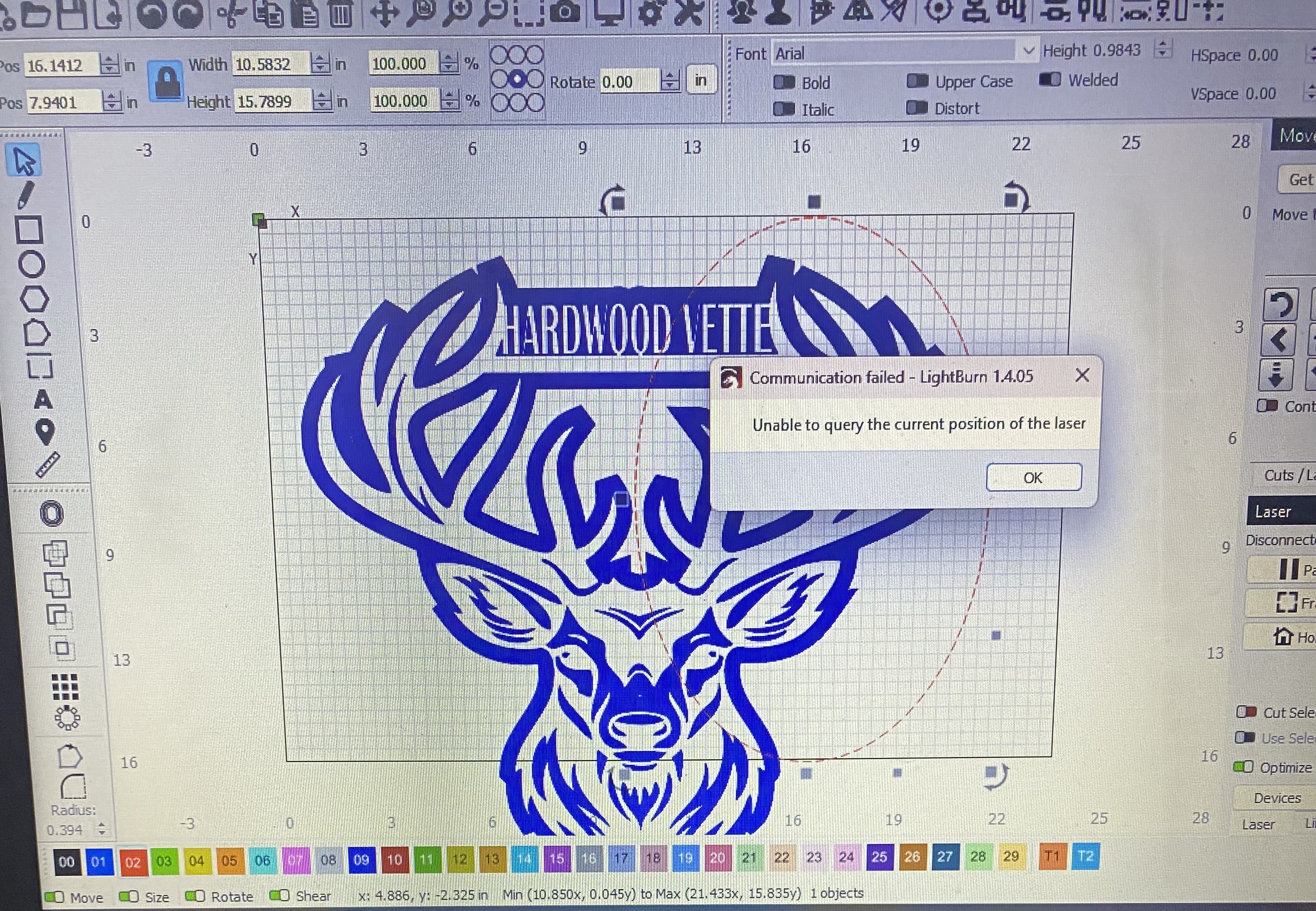

Yes, I was able to get “cut shapes” to work. When selecting print, do I select “start wizard” or “set first target position?” Thank you for your help
I would use the wizard for first time.

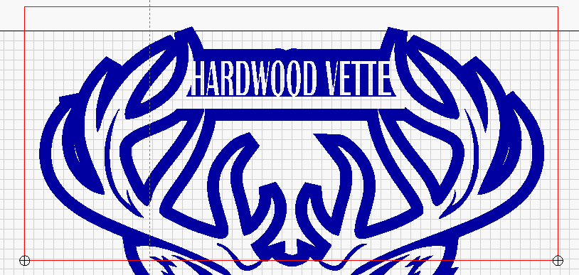

I did select “start wizard” first, and then I set the 1st & 2nd targets, then “aligned output targets (no scaling”). I’m unsure of how the outcome will be due to the location of the 2nd target (light blue circle).
I’ve never used it myself but i thought the ‘targets’ should be something like the ones i’ve got on the lower corners of the of the ‘cut tool’ (red line)
they’re just registration marks for setting the laser head.
I’ll try and check it out tomorrow on my machine if i get the time :crossed_fingers:
